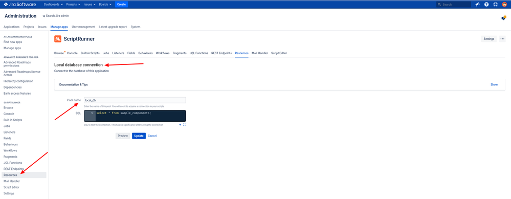

If you notice in the code, I am using the local_db as the connection name. Below is a print screen of the example DB Connection that I am using:-
In this example, I am just using a Local Database configuration, i.e. it will connect to the Database the Jira instance is using.

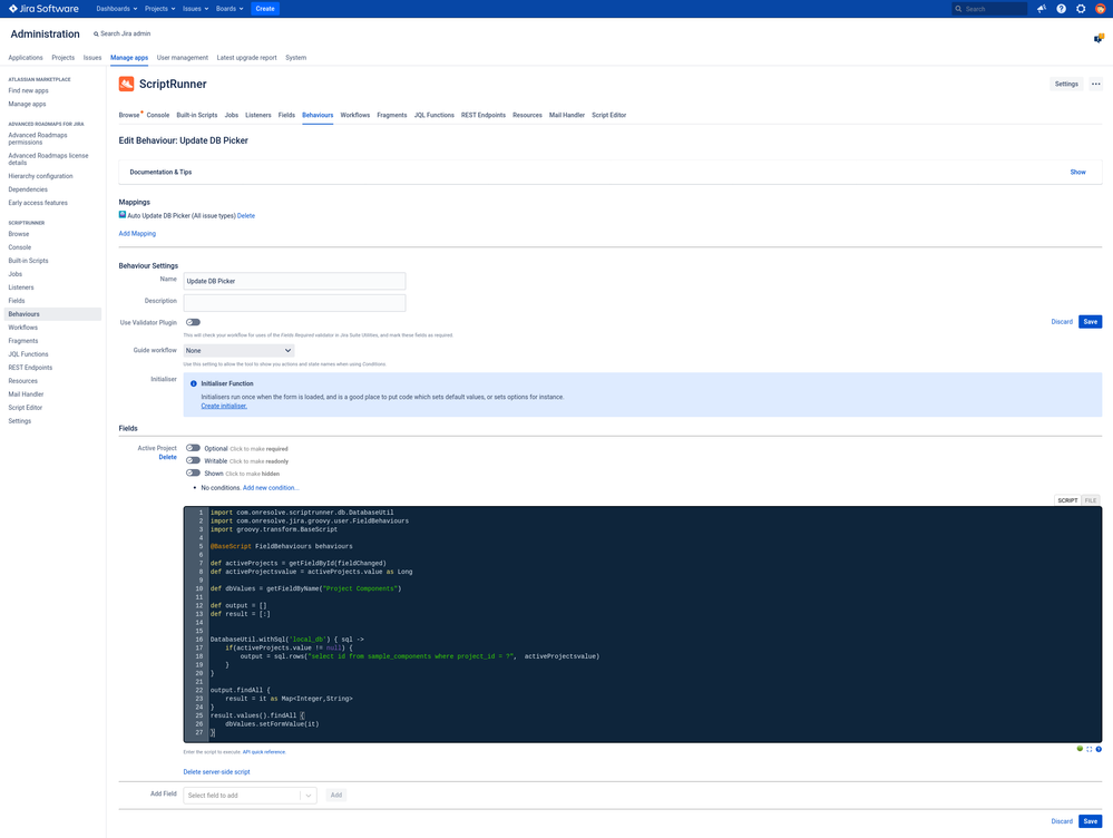

Below is a print screen of the Behaviour configuration:-

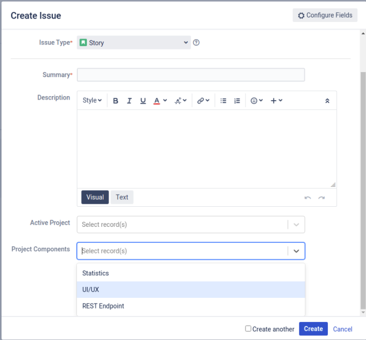

2) The Project Components DB Picker List

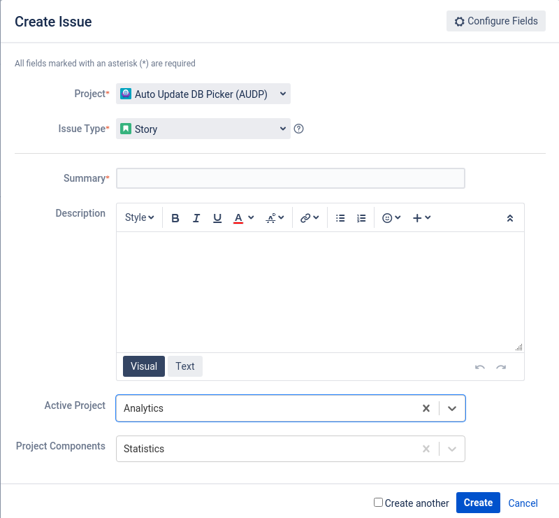

3) If the Analytics option is selected from the Active Projects DB Picker, the Statistics option is selected automatically in the Project Components DB Picker as shown in the image below:-

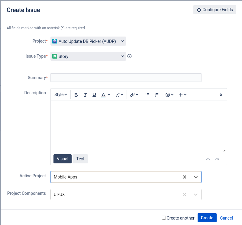

4) If the Mobile Apps option is selected from the Active Projects DB Picker, the Statistics option is selected automatically in the Project Components DB Picker as shown in the image below:-

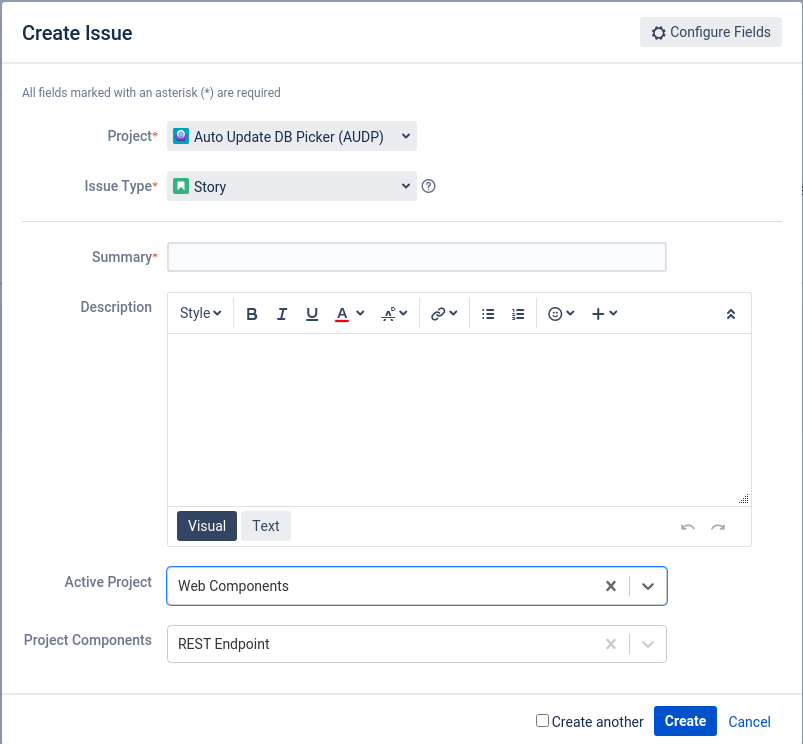

5) If the Web Components option is selected from the Active Projects DB Picker, the REST Endpoint option is selected automatically in the Project Components DB Picker as shown in the image below:-
