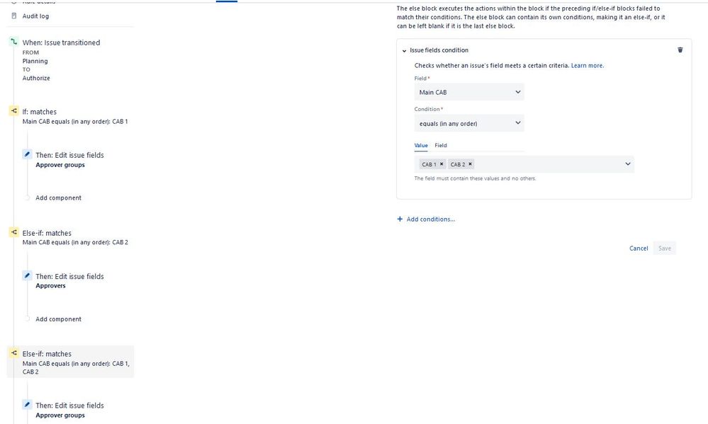

This is possible in Jira using Automation. You can create a loop and create a subtask whenever the condition is met.
Here is an example of an automated assignment of tickets based on the CAB value selected which is a multi-select drop down.
This can be customised as per your business scenarios.
Please let me know if you need any help on this or accept if this helps in resolving the query.
