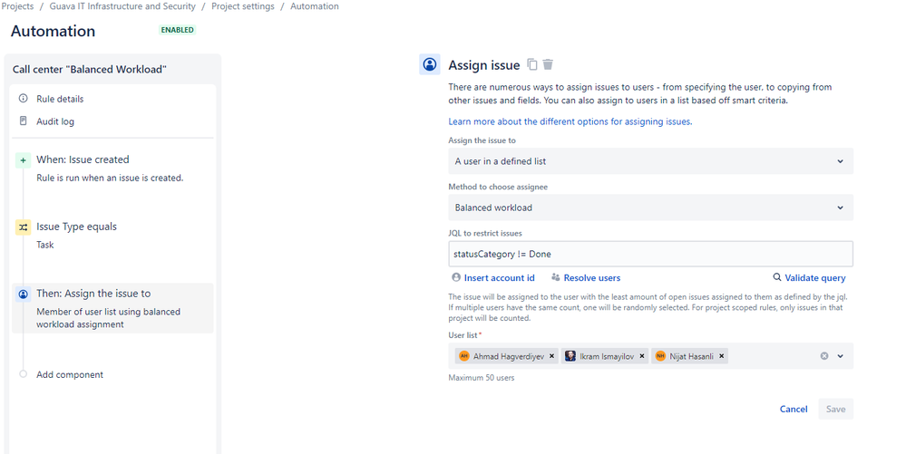

Hi @Aleksandr Ganiyev ,
You can do it by making use of project automation. Create Rule as below.
i.e. Go to Project settings --> Automation --> Create new
Create a trigger == Issue Created
Then Add an action == Assign Issues
Assign the issue to == A user in a defined list:
Method to choose assignee == Balanced Workload
User list == Add the required users
More options to assign issues is described in https://support.atlassian.com/cloud-automation/docs/jira-automation-actions/#Automationactions-AssignIssue
System checks for all the tickets assigned to the user and which is not resolved. Not only the present created tickets. Please run the JQL for three users and see their total non-resolved tickets.
In this screenshot(previously i have sent and now below) all tasks(issue type - task) which these employees have in this screen.
As you can see in screenshot with automation process i indicated issue type - task
Your project has atleast 8848 tickets (I see key GIIS-8448). Please check the count for each users using JQL provided in previous comment. Don't check only tickets created recently.
Ok i got it, i have checked it again and yes you are right this automation process works and assigns tickets depending on all amount of al open tickets but if i need to launch this process for one issue type - for example only for issue type "Task" as i mentioned in my case i won`t be able to do it?
As i see now it is not working by this logic.
