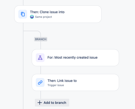

@Cláudia Silva I was able to reproduce the issue that you have mentioned here and I would assume it is the default behaviour of the automation rule. You can add an additional step as in the below screenshot to set up the 'clone' link between the new and existing issue as a workaround.

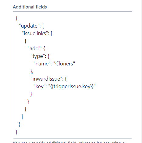

Cláudia Silva
May 27, 2024
Hi @Gikku , thank you so much for your answer.
I already tried that way but I wasn't successful either, the alternative I came up with and which solved the problem was to add an issue link of the "Cloners" type in the additional fields, just like the screenshot and thus adding the link to the original issue. ..
