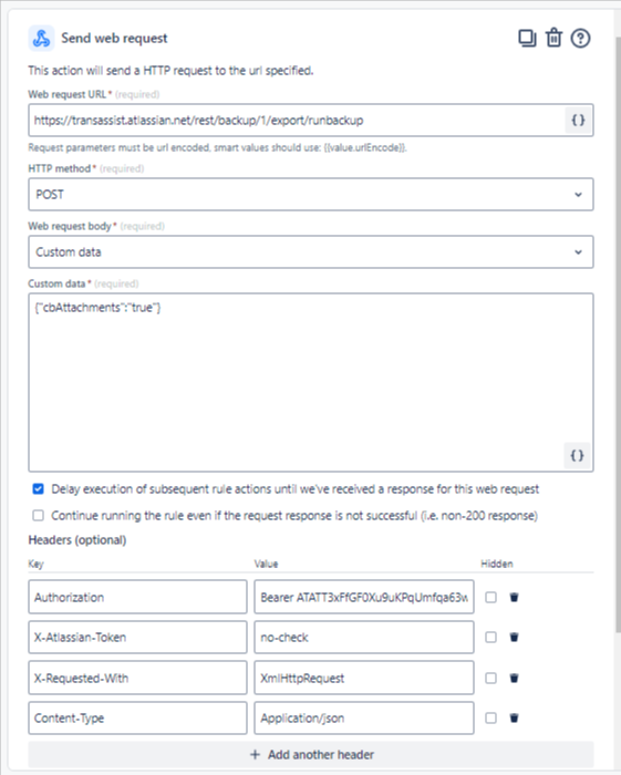

I have Created a Backup Automation rule to running jira backup from Jira Automation rule.
I did the same api token from the
My Account --> Manage Account --> Security --> Api-tokens --> Create Token --> Copied and used here.
But it still shows the error.
Used this Page as everyone has linked upon in Community.
Automate online site-backups for Jira
[Note: This is being tried in my test Jira Account[Free tier], but If it succeeds, I can work upon the live Jira Base.]
So is there anything I'm missing or is there any other ways for achieving it ?

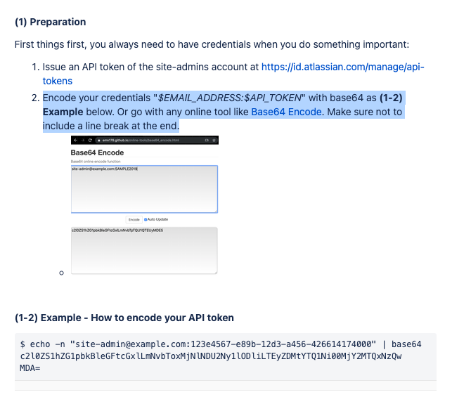

Hi @Santhosh Raj
Since you are getting HTTP 401 and 403, it is likely due to the API token you copied is not encoded as listed in the community post under the preparation section:
Screenshot 2024-04-24 at 11.27.55 PM.pngThank you.
