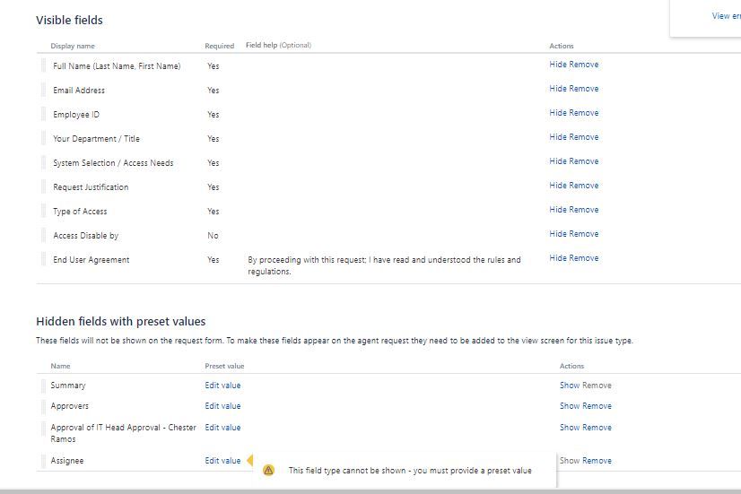

3. At the moment, "Assignee" custom field is hidden by default, is there a way to unhide it and input the email address of the IT Engineer accountable for the ticket type? (Or I can create a new custom field)
Looking forward for your help and assistance:
1. Below is the Customized form for a Service Request:
  (As you can see , I need to enter the "assignee's email address" as the assignee custom field cannot be shown with the form, in other words each form will have different assignee email address)
2. Below is what a typical form looks like.

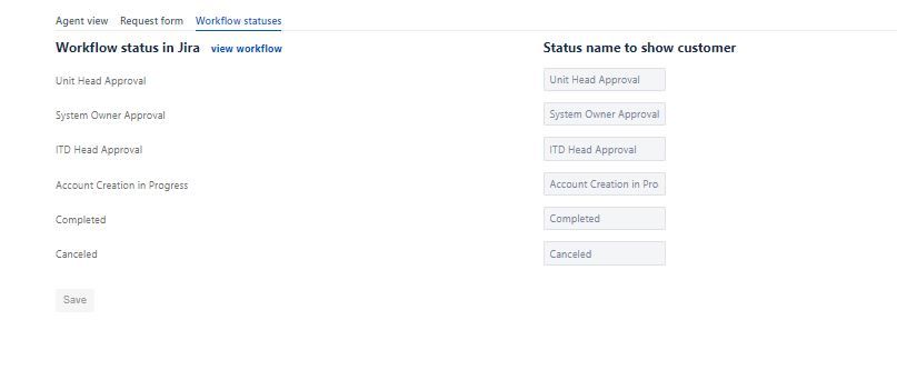

3. Here are my workflow for such and workflow Statuses for the form above:
From the process flow , where does the custom field "Assignee" comes in?
wf.jpgSR WorkFlow.JPG.

With basic automations delegating issues to users based on issue/request type in the same project isn't really possible.  From my research it appears that you can find some plugins that will allow you to script it.
I was trying to break out a ticket that had multiple parts that needed to be done, and assign them as subtasks to the appropriate people when it is created.  The problem was the automation targeted everything involving a subtask in the project.
My solution was to break out the types into separate projects rather than issue groups.
The problem that poses is say now HR wants to use Jira Service desk, the main portal for IT will always show the HR project as well.  You can hide projects from certain customers, but where our customers are all in the same company this is not effective as they will need both services.  Aside from paying for another Service Management License i have not found a work around, which is not really cost effective when hosted.
