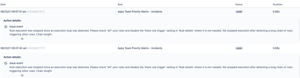

Hi, I keep getting "LOOP" status in some of my automations. This leads to sending me emails each time something is in LOOP status.
I tried to read up about it and see whether it's an error, but it isn't clear to me.
I have some automations that run after other automations. Due to the multiple other automations, this specific sometimes doesnt get updated in time, therefore I do RE-FRETCH and since then, i do get this LOOP status issue.
Appreciate your help understand if there is anything I should be doing differently.

Yes, this started when i added re-fetch to specific automation. And as a result, other automations that are "Allow rule trigger" on this specific automation, put these automations in a LOOP status. So am 99% sure this is the issue.
This is just one of the same errors I am getting after i added the re-fetch from another "Allow rule trigger" automation:

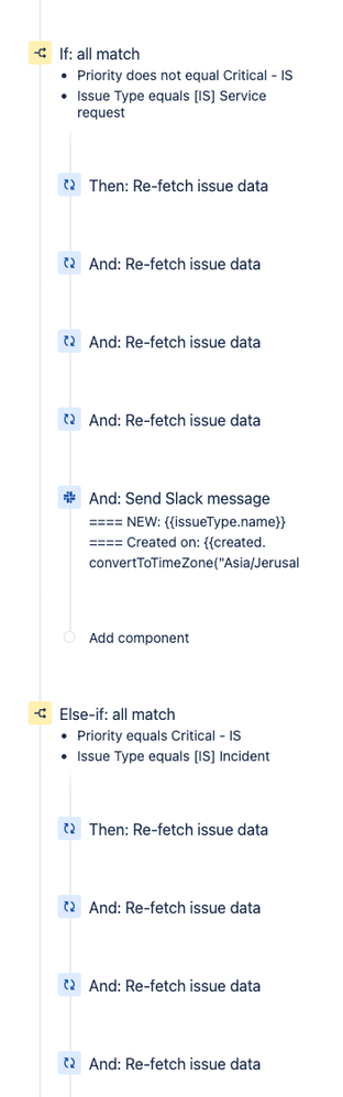

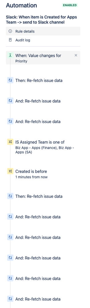

Basically I have multiple automations running when an item is created/updated/value changed. When an issue is created, I send a webhook to an external service, and that service updates specific item's fields via Jira APIs. In another automation, i also send a Slack message. The reason I put a re-fetch, is that the Slack message was being sent before those fields from the API have been updated. So that slack message with those fields would come out empty. When i added all those re-fetch, those fields were eventually populated and i sent the Slack message. The problem as you can see causes this LOOP status in other automations.
So i guess the problem is not the LOOP status but rather how can i prevent using re-fetch by delaying an automation? Does that make sense?
Here are the re-fetch...its crazy!

@Alex Koxaras -Relational- ok i think i got it. I did a bit of a workaround. Instead of changing the priority no created issue, i waited for it to change a status, only then that automation runs and so is the next ones I needed. So I removed the re-fetch as it is no longer needed.
thanks!
