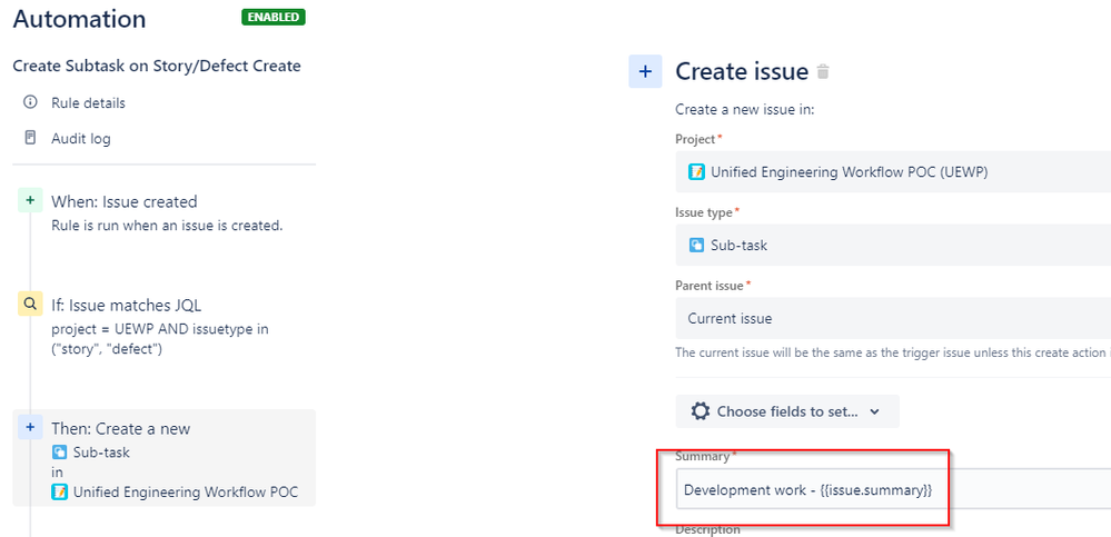

Hi, @David Lord - you can definitely have your automation rule create the subtask summary to contain data from the parent ticket. If you're not super-familiar with automation yet, smart values are your friend!
Here's what your rule setup could look like:
The text in the curly braces is pulling the value of the parent issue's summary.

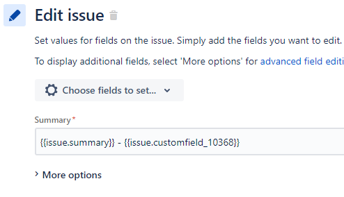

You're welcome. I don't know what to tell you about the employee field, but I tested a date field named start.date, and got nothing with the field name smart value, because I think Jira thinks that you're using a field called start with a property of date, which doesn't exist. I tried again using the customfield ID in the smart value, and it worked correctly.
You can find the custom field ID by going into the configuration of your custom field; the URL should look something like this, with the ID being the bit at the very end:
https://<your site.atlassian.net>/secure/admin/ConfigureCustomField!default.jspa?customFieldId=10368
