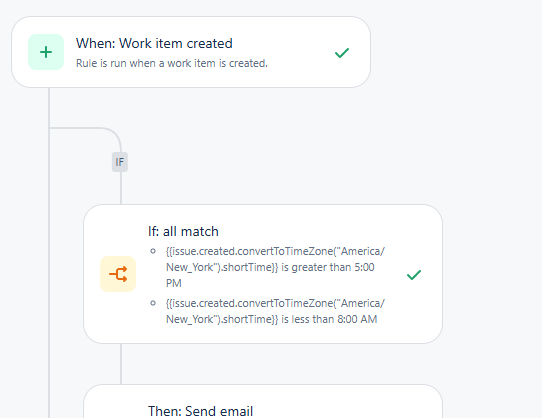

This is the rule:

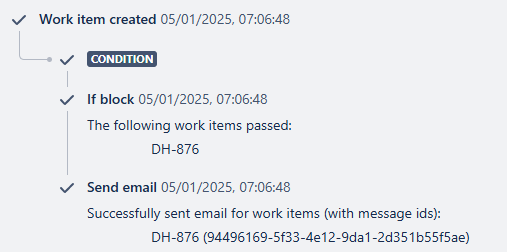

This is the expected behavior.

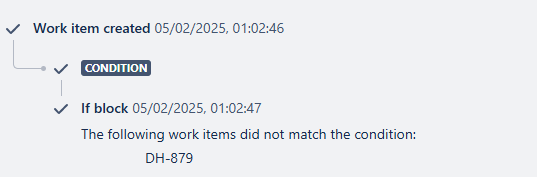

Sometimes we get this when I believe it should be sending.

So the work item doesn't match the conditions set on the automation rule in the If: all match
Looking at the conditions, you convert the created time stamps in the condition, so it can be based on the original created tie that based on the conversion one or both conditions fail.
I mean an issue is created at time X, if you convert this tom time zone America/New York, but if this is before or after 5pm or 8 pm New York time the condition fails.
All correct, but the converted time of 1am falls between the If:all match conditions of after 5pm and before 8am, right?
Depends on which time zone is used in JIra?
01:00AM UTC converts to New York 09:00PM
So this is greater then 05:00PM, but greater then 08:00AM, so this will fail the condition.
The ticket creation time from the API shows as created "2025-05-02T01:02:44.725-0400" and the default time zone for the Jira instance is set to (GMT-05:00)New York
Also, the rule conditions are greater than 5pm and less than 8am so even if it took it as 1am UTC and converted that to 9pm New York time it should still satisfy the defined condition.
What really confuses me is that a ticket entered at 7am does not fail the conditions.
Instead of using a text value for the time to compare agains, I changed it to this for better reliability as noted here (Solved: Create After Hours Ticket Creation Notification)
{{issue.created.convertToTimeZone("America/New_York").withHour(17).withMinute(0)}}
