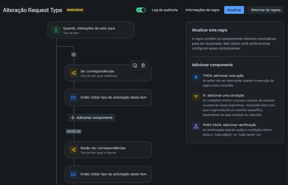

I have a challenge to make an automation in JIRA so that whenever a type of the item is changed, also change the Request Type, so that the customer can view it on the Portal.
I did it as follows:
1. Whenever the item type is changed, it triggers the automation
2. I make a condition to validate the type of item

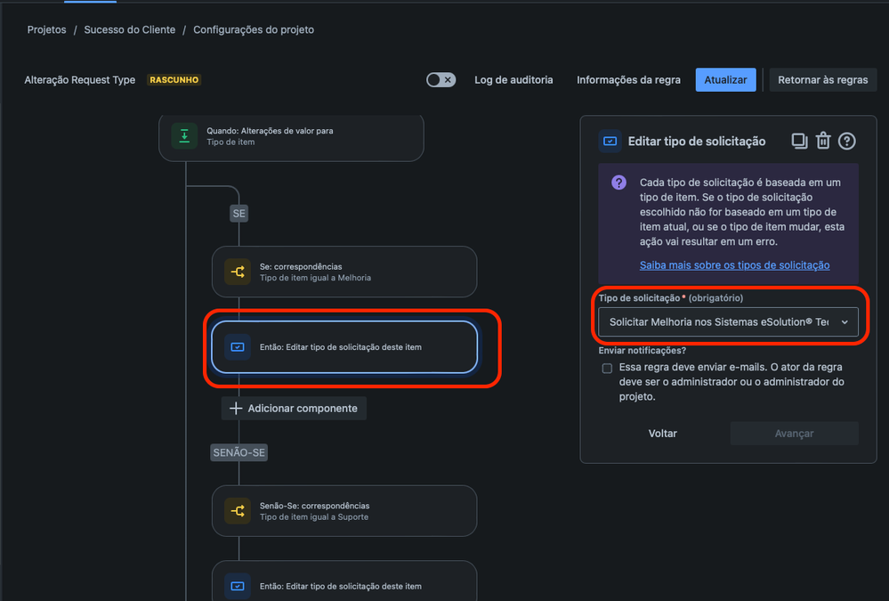

3. Based on the type of item I use the action of Edit the request type by defining the corresponding request.

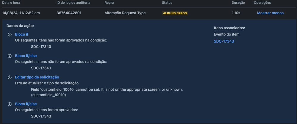

However, it is generating an error:

@Lucca FernandesThe project SDC is an actual JSM project? Your trigger is a field change but maybe the issue that triggered it is not from a JSM project, so it can not find customfield_10010 (Request Type)

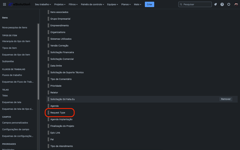

1. Please ensure that the "Request type" field is included in the edit screen for that specific issue type.

Lucca Fernandes August 14, 2024
Hello @Samuel Gatica (ServiceRocket) , thank you for your feedback.
Yes, I've already checked the screen issue:
Regarding the type of item, I have a type of request for each type of item, in this case what I am changing also has another type of request associated
