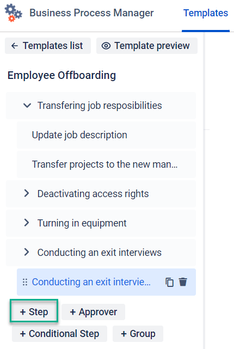

Hi @Sam Fowler ! For the offboarding process, we recommend creating a process template, where you add all steps(Jira issues) that have to be done to minimize company risk.
A standardized employee offboarding process not only mitigates legal and security threats, but also helps you gain honest feedback from employees on where to improve your organization.

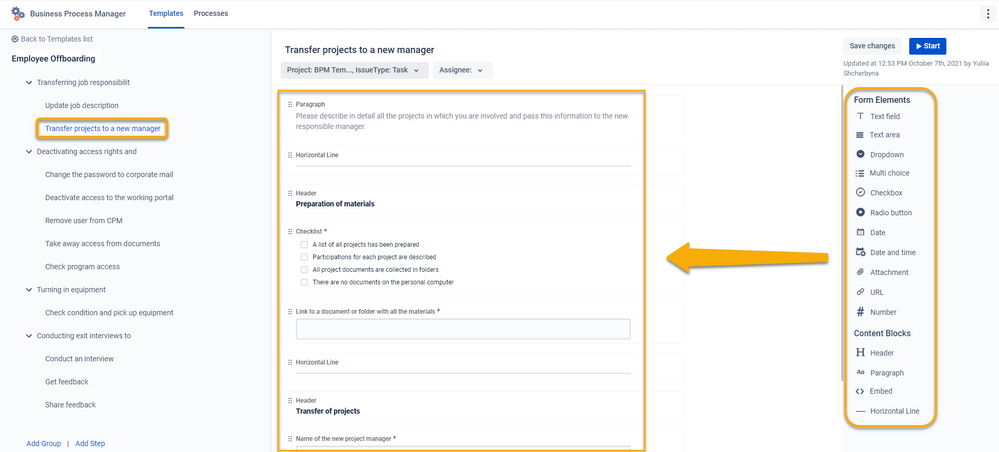

The main steps you need to take to organize the process using the Business Process Manager plugin developed by my team:
  1. Create a template with all the steps of the process

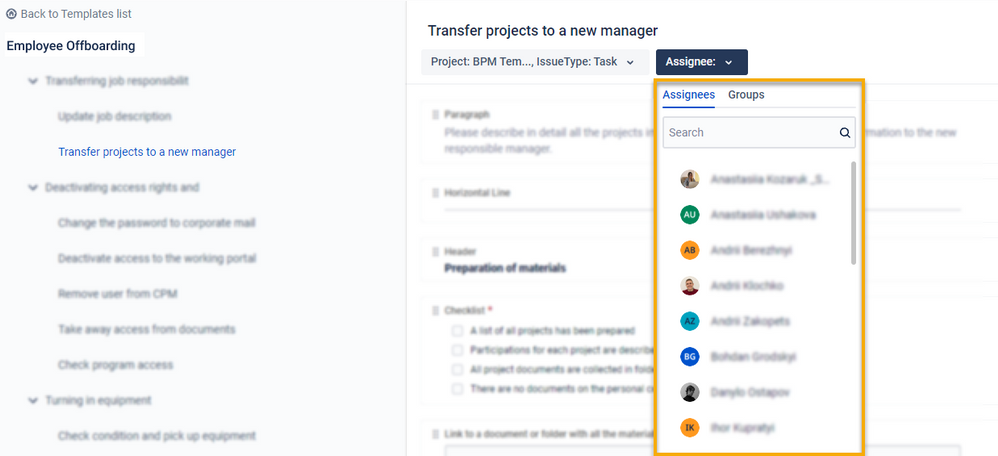

  4. Start the process when needed manually or use Jira Automation to start the process as an action after the selected trigger (etc. create an issue with label "offboarding" in HR project)
