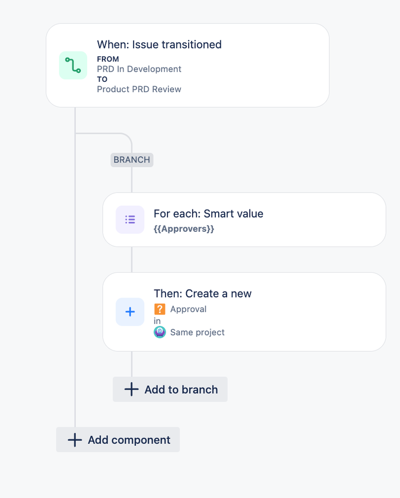

I have a field in my JIRA ticket called Approvers and sometimes there are 2-3 different individuals assigned as approvers. I'm working on automating the approval process and would appreciate guidance on setting up a rule. Specifically, when the issue transitions from In Progress to Under Review status, I want automation to create subtasks and assign them to the users listed in the Approvers field. Each approver should have a unique subtask assigned to them.
Has anyone implemented a similar automation? Any tips or insights would be greatly appreciated. Thank you!

You can setup an automation rule to create sub-task or you can create a post function on that particular transition in the workflow.
The situation you may run into is having the automation create sub-tasks and assign them from a list of users. It's possible with copying the came value from a user-picker field. Haven't come across assigning from a list of sub-task from a list of approvers from out of the box configuration.

Where the assignee field is set is in the create new Issue action. If you go to the action, select assignee to be set. There should be a drop down menu to provides the list of option that the assignee field can be set to with Jira automation. If this is limited, you might take a look at the work flow transition and set the field by using a post-function.
