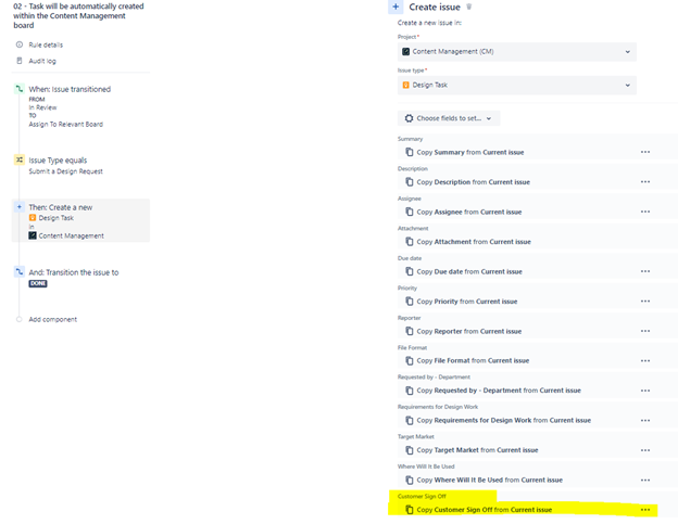

I need to create a new issue within Jira Software following an issue being created within Jira Service Management.  Both are set up as Team Managed and the issue types in both projects have been set up with the same fields.
The outcome of this is that every field correctly shows in Jira Software apart from one (Customer Sign Off which is a "People" field type) and I have no idea why it isn't "copying" over the same as all the other fields.
Pic 1 shows the automation rule used and highlighted is the field that is not copying data over

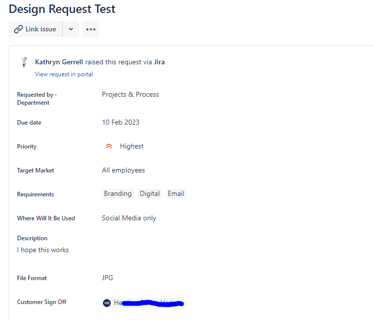

Pic 2 shows Customer Sign Off field populated within Service Management project

Does anyone have any idea why this isn't workingPic 1.png for me please?!
