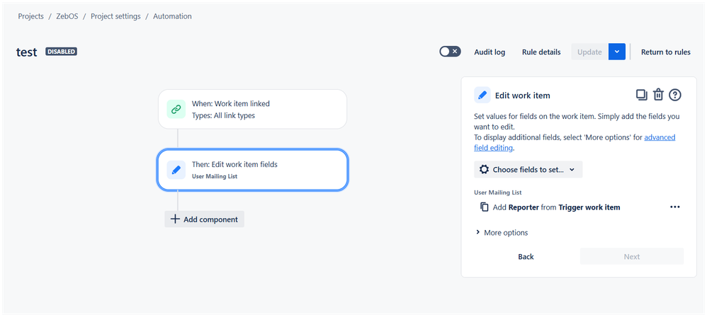

Hi @Trudy Claspill i have shared the Automation rule , please check

Sachin Guttala
April 25, 2025
Sachin Guttala

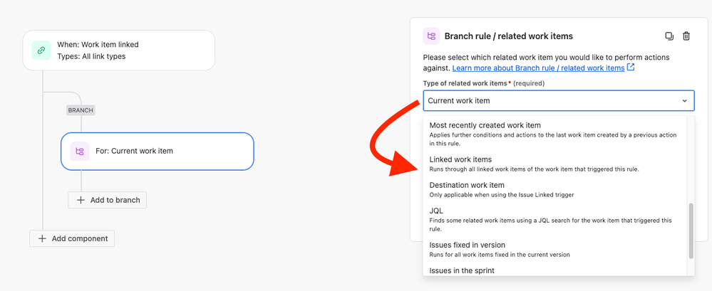

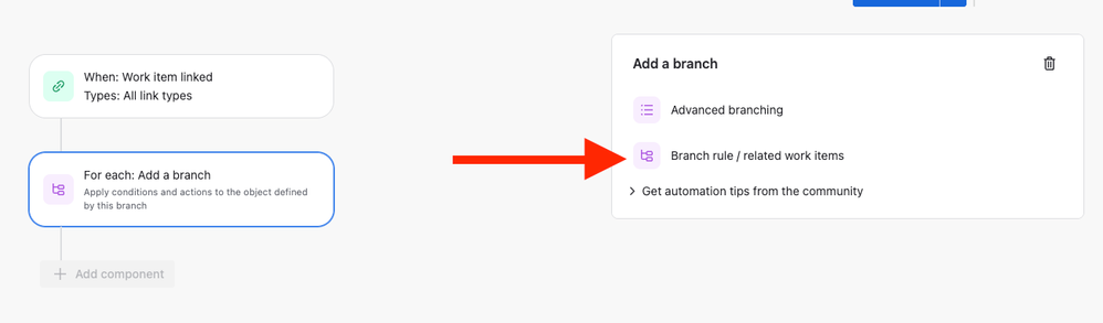

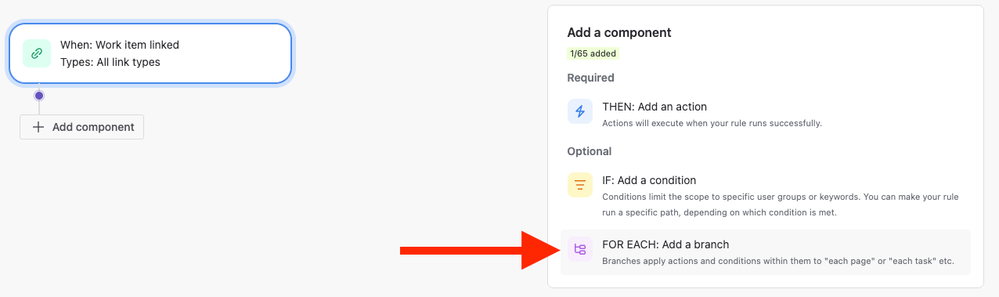

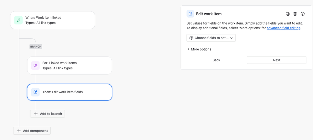

Your rule does not include a step to change the focus of the rule from the issue that triggered the rule to the linked issue(s) you want to update.
At the time your Edit action executes, the rule is still focused on the issue that triggered it, so the action is telling Jira to copy the Reporter to the User Mailing List in the same issue.
You need to add a Branch to change the focus to the linked issues.
Screenshot 2025-04-25 at 1.13.08 AM.pngScreenshot 2025-04-25 at 1.14.01 AM.pngScreenshot 2025-04-25 at 1.14.50 AM.png
You also need to check the Project Scope of the rule, as I mentioned previously, and ensure that it includes all the projects that contain issues that might be used in the links you create.
And, as I also mentioned, you need to consider how you are linking the issue together; which would be considered the source and which the destination. Otherwise the data may not copy in the direction you expect.

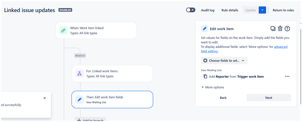

Sachin Guttala
April 25, 2025
@Trudy Claspill @Trudy Claspill i have tried altering automation but i am not seeing success please help , i have attached rule detailsScreenshot 2025-04-25 154251.png
