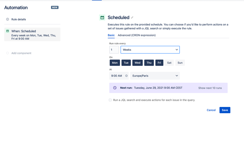

Hi @Mariano ,
if you're using the Scheduled trigger in Automation, I believe you can do something like this :
Let me know if this helps,
--Alexis
This is genius @Alexis Robert !, exactly what I was looking for.! Thank you so much and have a nice day!
Ah, but this is for the weeekly one. I was looking more into the rule running hourly, but not on weekends. I guess you can't have it all! lol
