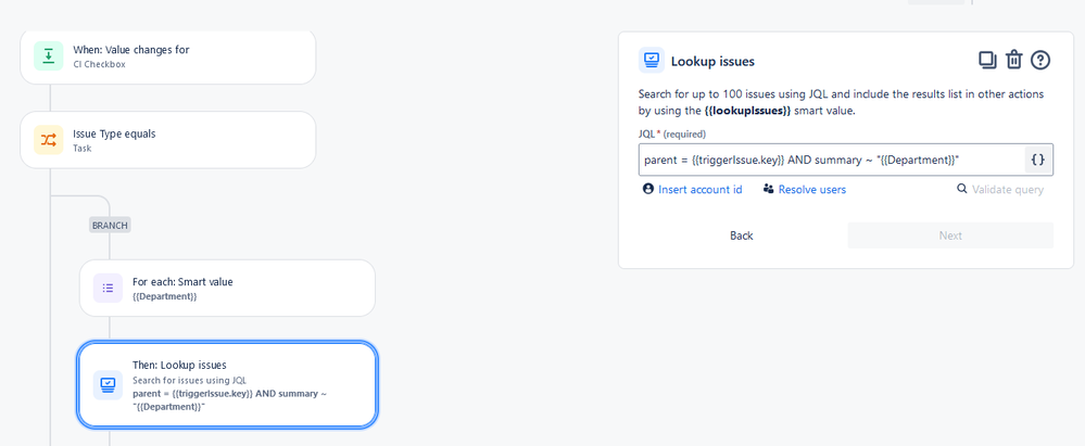

Hi @Trudy Claspill - I have been trying to play around with this and I found a few other posts also on Atlassian Community but I cannot seem to get it right.
This is the automation I had that I went off base don this with some modifications (https://community.atlassian.com/t5/Jira-questions/Automatically-creating-Subtasks-from-a-Checkboxes-field/qaq-p/2515668) but the issue is that the other sub-tasks are still getting created so there is probably an issue with the "Lookup issues" and "Compare values".
Hello @Drishti Maharaj
Please provide screen images that show the entire rule, not just the branch.
Also, please provide the details of your For Each: Smart Value step.
And, as @Bill Sheboy note in the other post where you asked for help, you need to enclose Department in curly quotes where you are trying to use it in the JQL of the Lookup Issues action.
