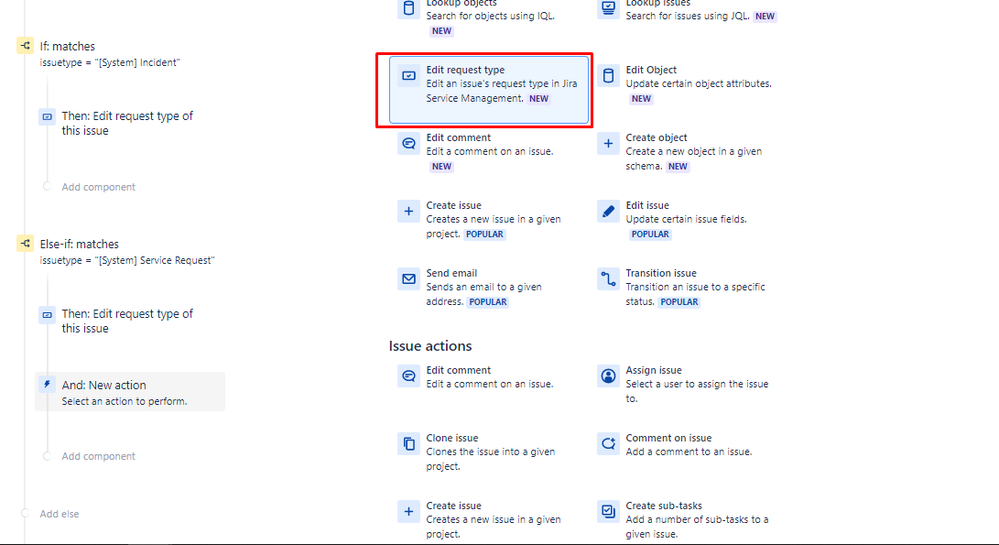

You can change the request type within your initial rule by adding a branch. Try the following:
I don't know what your trigger is, so keep that unchanged. Carefully create such an issue type, for which the specific request type exists. Otherwise this rule will fail.
I've tested it and works like a charm!

We have to use the another action for it. There is one new action introduced to Edit request type for JSM itself.
Like this:
