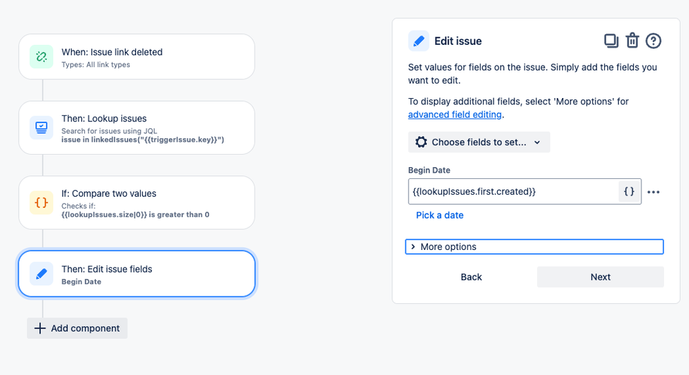

What value would I put in the for issue key? The smart value isnt working.
Please provide a screen image showing your complete rule. I can't tell you why it isn't working without that information.
This is an example of such a rule.
HOWEVER links are considered directional. When you remove a link two issues are affected. This rule will not necessarily be triggered by the issue you are viewing when you remove the link. It will be triggered by the issue that is considered the "source" in the link relationship.
Link Types have an Inward and Outward Description. For example:
link type name | Inward Description | Outward Description |
Blocks | is blocked by | blocks |
If the link between two issues is:
ABC-1 blocks ABC-2
ABC-2 is blocked by ABC-1
...then ABC-1 is considered the "source". When viewing ABC-1 you would see "blocks" (the Outward Description) in the Issue Links section, describing its relationship to ABC-2.
So, if you were viewing ABC-2 and removed the link to ABC-1, the rule would actually be triggered for ABC-1.
Its all good I used the lookupissues action and ordered them to have the oldest ticket first. I then clear the field that was storing the date of the oldest linked ticket, then input the created date of whatever the now oldest ticket is. Which then kicks off my calculations. So it now works for linking and unlinking.
