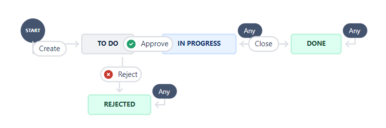

The workflow for the issue is as follows:

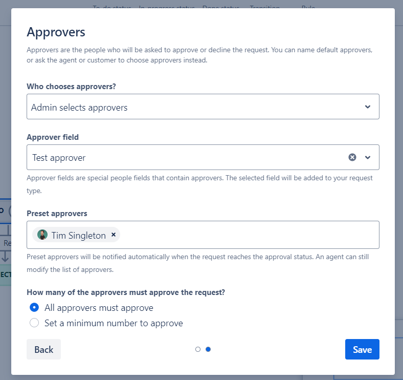

The approver in the workflow is as follows:

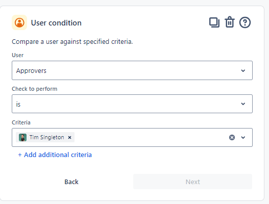

I have tried the following condition for step 2, but it does not trigger the workflow.

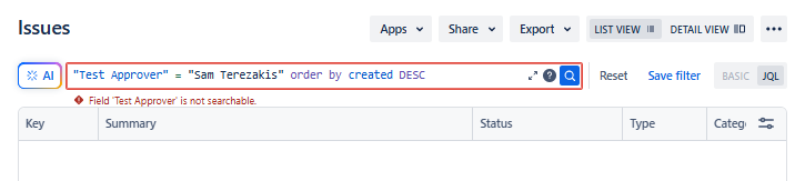

I would suggest instead of a user condition to use a JQL condition for "Test Approver" = "User" and then you can also check in the issue search that the list of issues you're trying to make this rule work for is returned.
Please can you try and see if this works for you?

It's returning the following error
Here is a screen of the issue
Hi @Sam Terezakis , thanks for the screens. I have done a little searching and I think you might be encountering this problem
https://jira.atlassian.com/browse/JRACLOUD-85929
I know it says in the first page that it is impacting only Data Center but I think the issue is the same in the sense that the custom field you created in the team-managed project is not able to be processed by the JQL as the Jira query doesn't access the 'search template' for the field. Let me escalate this to Atlassian support and see what they have to say as a possible workaround.

I understand that the automation is not working as expected here. Part of that appears to be due to the conditional used. The comparison seems to be looking at the default "Approvers" field. However in your example you appear to have created a "Test approver" field instead. Adjusting that might be all that is needed to correct this. But then again it might not be enough to resolve the problem.

Thanks for the response. I have the correct permissions to view the issue. I have searched for the issue using the following query, however it doesn't return any results.
"Test Approver" = "Sam Terezakis" order by created DESC
Note, "Test Approver" was created from the approval screen in workflow configurator and it does not appear in the list of custom fields from the global settings menu.
