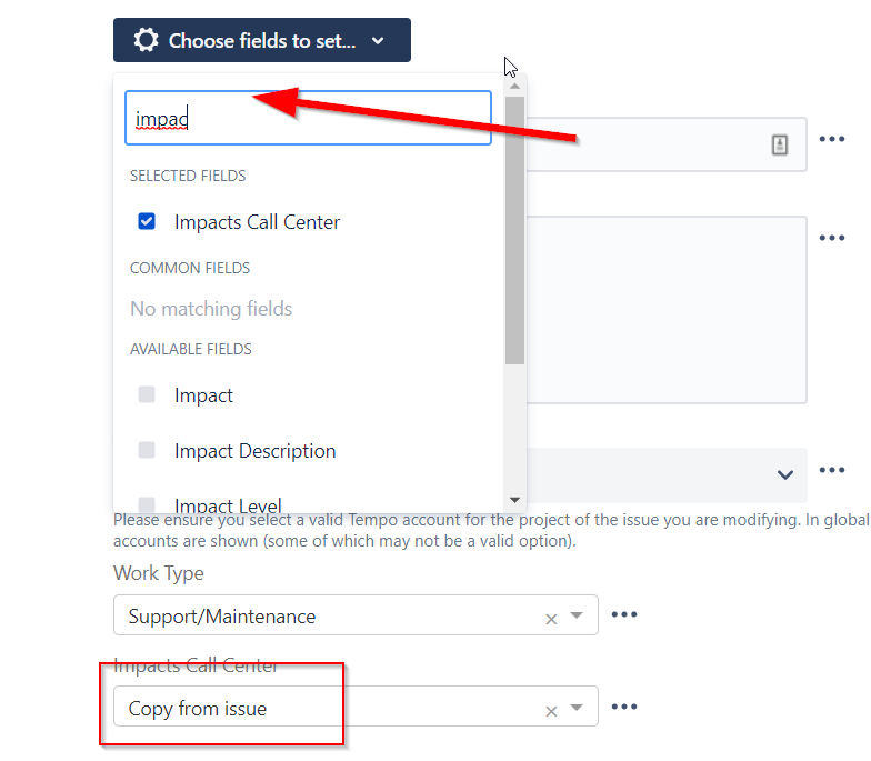

If you want to include the value of that dropdown field on the new issue in Project 2, you can do that in the Action step. Assuming that field exists in the field configuration and on the task screen in Project 2, you can just select it from the Fields to Set dropdown and select Copy from Issue.

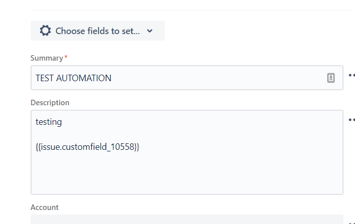

If the field doesn't exist on your destination project/screen, the rule will error out when it runs. If you want the value on the new issue but don't want to add the field itself, you can append it to another existing field, like the description field, with a smart value.

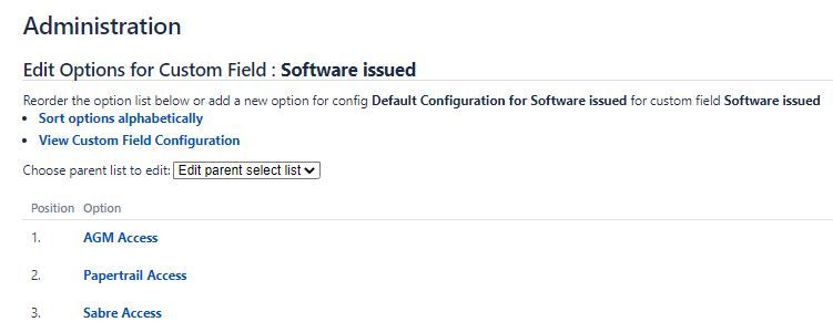

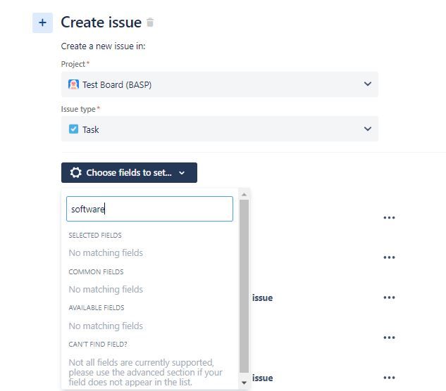

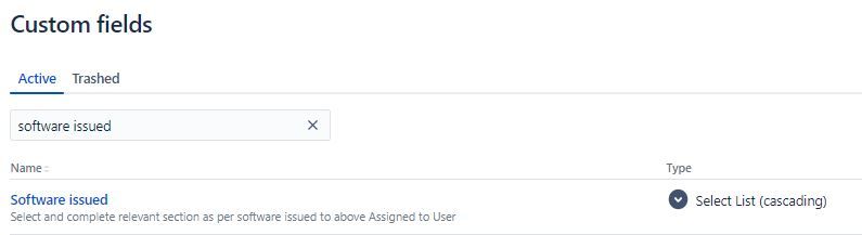

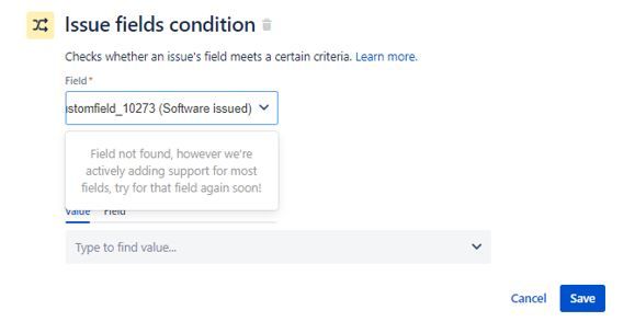

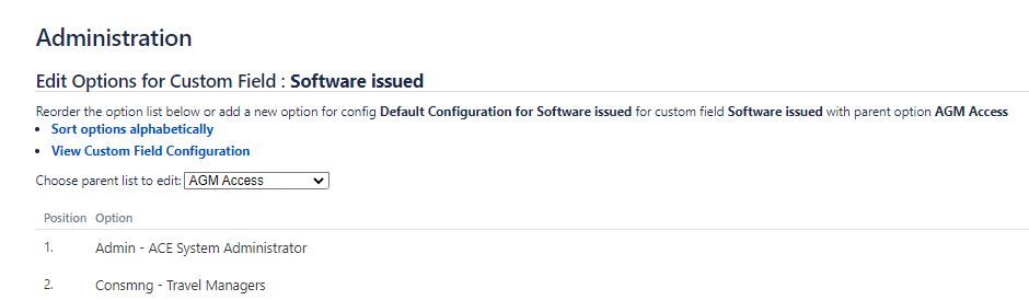

However, I have tried to replicate the steps shown above and it seems like I cannot specify the custom field in "Issue fields condition". I have looked up the custom field and it's value on my side.
Is it perhaps not possible using "Select list cascading" Custom Field - Software.JPGIssue field condition.JPGCreate issue - software.JPG
What I am trying to do works when I use "checkboxes" when creating a new custom field. However I would like to try it with a field that has different options e.g - 1st drop down - details pertaining to the 1st option, 2nd drop down - details pertaining to the 2nd option.

I'm sorry I missed this! You're correct; I don't think this kind of rule works with cascading select lists. You might try contacting Atlassian support and reporting this as a technical issue; they may have more info.
