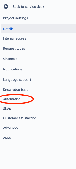

Hi @Petter Gonçalves Thanks for your help. I'm trying to follow your steps but I'm stuck with finding Project Automation. I only see Automation in the Service Desk Setting.
After I clicked the Automation in the screenshot, it is the same place that I can't add the smart value.
Please help me to find the Project Automation. Thanks.
Petter Gonçalves
October 9, 2020
Hello @Miyoung Mary Kim
I believe you are using a Next-gen project. Is that correct?
If that's the case, I believe the project Automation must be displayed under the Apps menu:
Can you confirm that?
Miyoung Mary Kim
October 9, 2020
Yes, I'm using Next-Gen Service Desk. Yes, I found the project automation under Apps! will try it now. Thanks!
