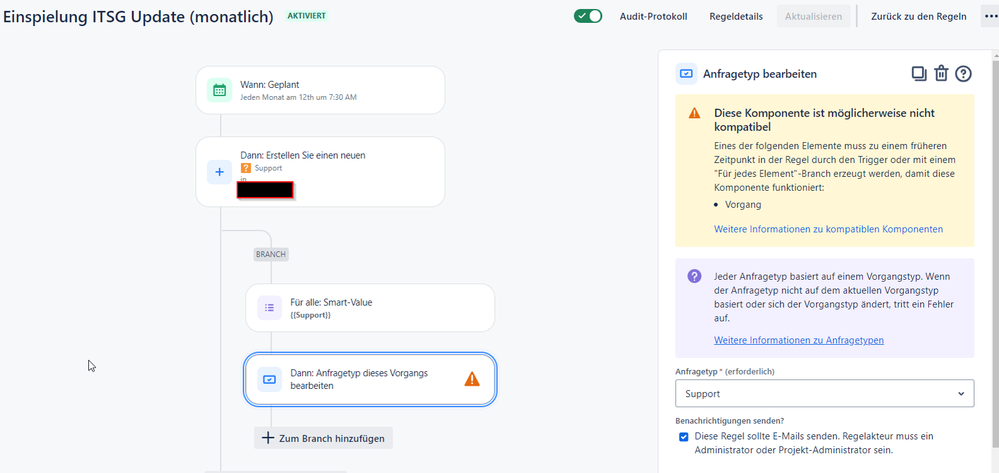

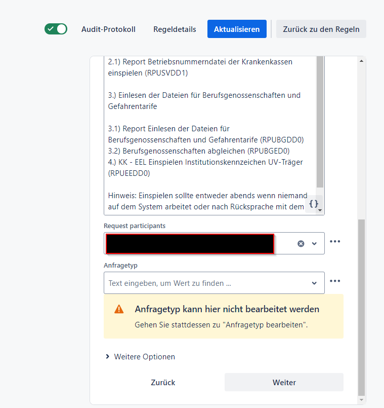

Now I have created the following, but receiving a warning message.
You have a solution for this?

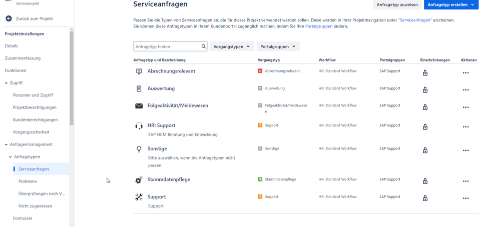

Why can't I select the Support request type here?
In the project I see the following request types:

Regarding the warning message you showed in your later post, that indicates that you are using an action that requires there be an issue in context for the action to be executed against. You have used a Branch. Can you show us the details of that Branch?
You are also using a Scheduled trigger in that version of your rule. Please show us all the details of that trigger configuration.
Can you explain to us in sentences what you are trying to accomplish with your rule?

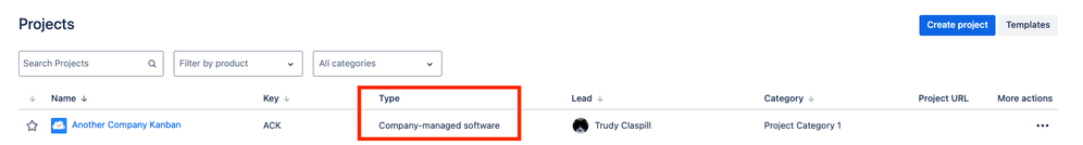

3. In what type of project are you trying to create that issue? Get that information from the "View All Projects" page under the "Projects" menu. Find your project in the list and tell us what it says for that project in the "Type" column. Example:

I want to create an issue type "Support" like it is shown in my screenshot (orange) because there I can assign a request participant and a description. But in the creation of a issue type a can't assign a request type directly. So I tried to modify the issue type later on with the branch based on the current issue type (Support/orange). But after saving the rule the error occurs.
It is a Jira Service Management Project.
Thanks for your help.

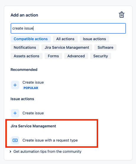

There are two actions available for creating issue.
One is named "Create Issue".
The other is named "Create Issue with a request type"
It looks like you are trying to use the first one -:"Create Issue".
To set the Request type in the same action where you are creating the issue you need to use the second action - "Create Issue with a request type".
If you use the second option then you don't need a second rule to modify the created issue later.

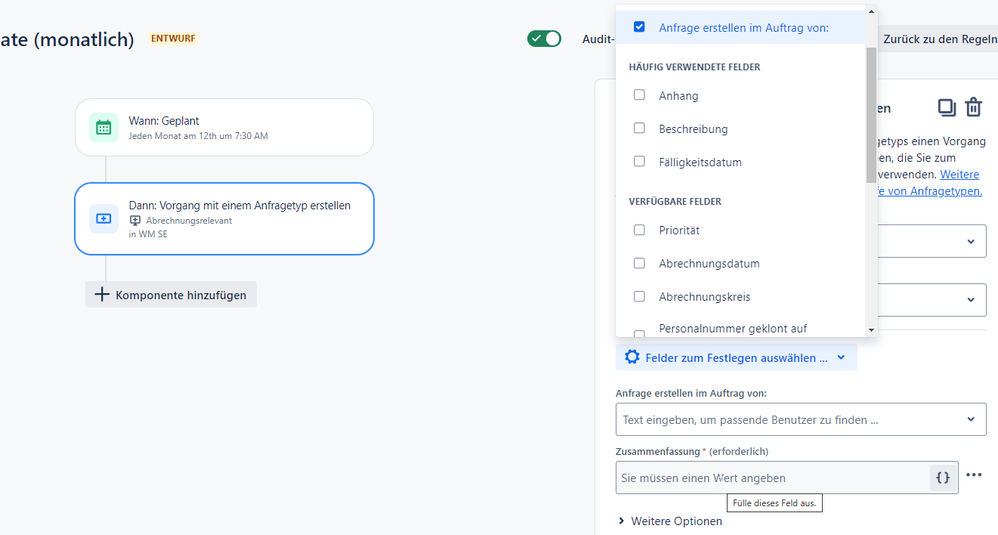

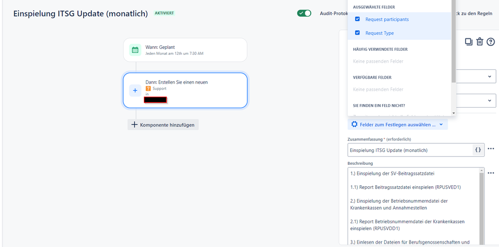

if I use "Create Issue with a request type" I cannot enter request participants.
It looks like this field is not assignable. I can't find it here:
The description is possible and I can choose the field description (Beschreibung). But request participants is not available.

You can update the Request Participants field using the More Options / Advanced Editing with JSON feature available in the Create Issue with a Request Type action configuration. Here is reference material for that.

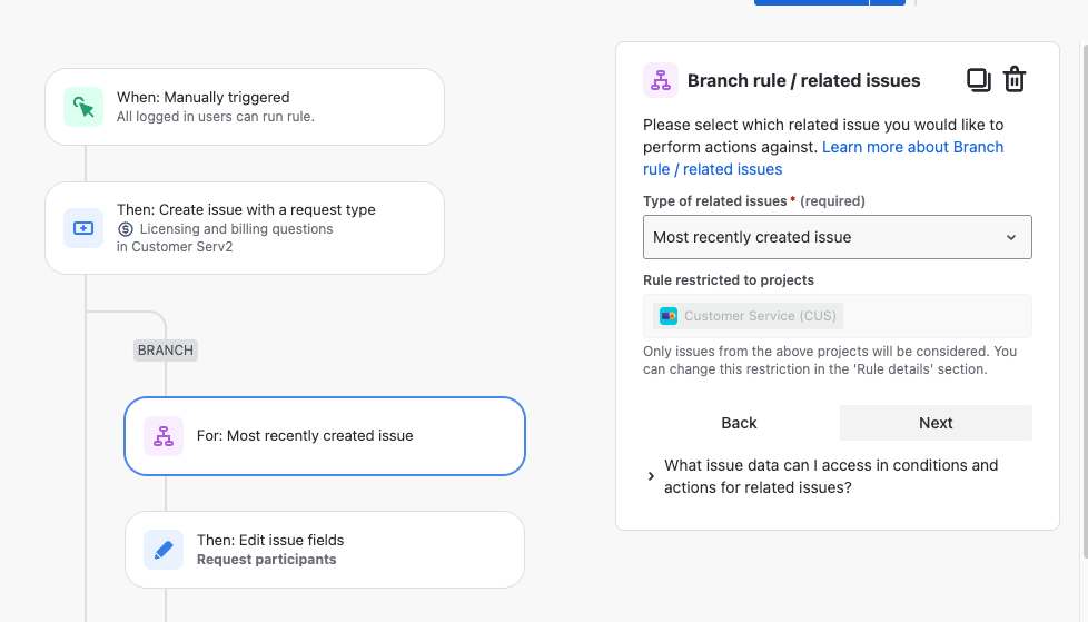

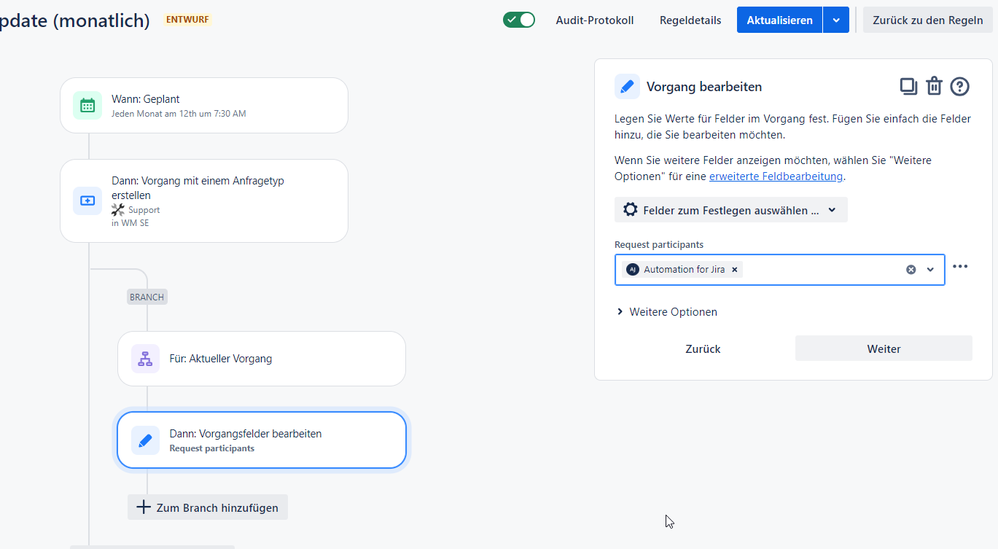

Another option is to edit the issue after you create it, in the same rule. You can use the For Each: Related Issues: Most Recently Create Issue branch option, and an Edit Issue action after that.
For the first solution:
How can I add a specific user? What should I enter here:
"update": {
"Request participants" : [
"add": {

For the second I'am receiving warn message:
For the first solution you have to replace this
{{issue.comments.last.author.accountId}}
with the users actual Atlassian Cloud account ID. You can get that by finding the user through the Teams menu search function. When you click on the user there the account ID will be shown in the URL. Example:
https://yourBaseURL/jira/people/62bbbb2222111209f4fcdef71
That assumes the user already has an Atlassian Cloud Account. You can't add them as a Request Participant in the Automation Rule if they don't already have an Atlassian Cloud Account.
For the second implementation in the For Each branch make sure that you choose Most Recently Created Issue, not Current Issue. If you choose Most Recently Created Issue, then the rule should work even with the warning.
