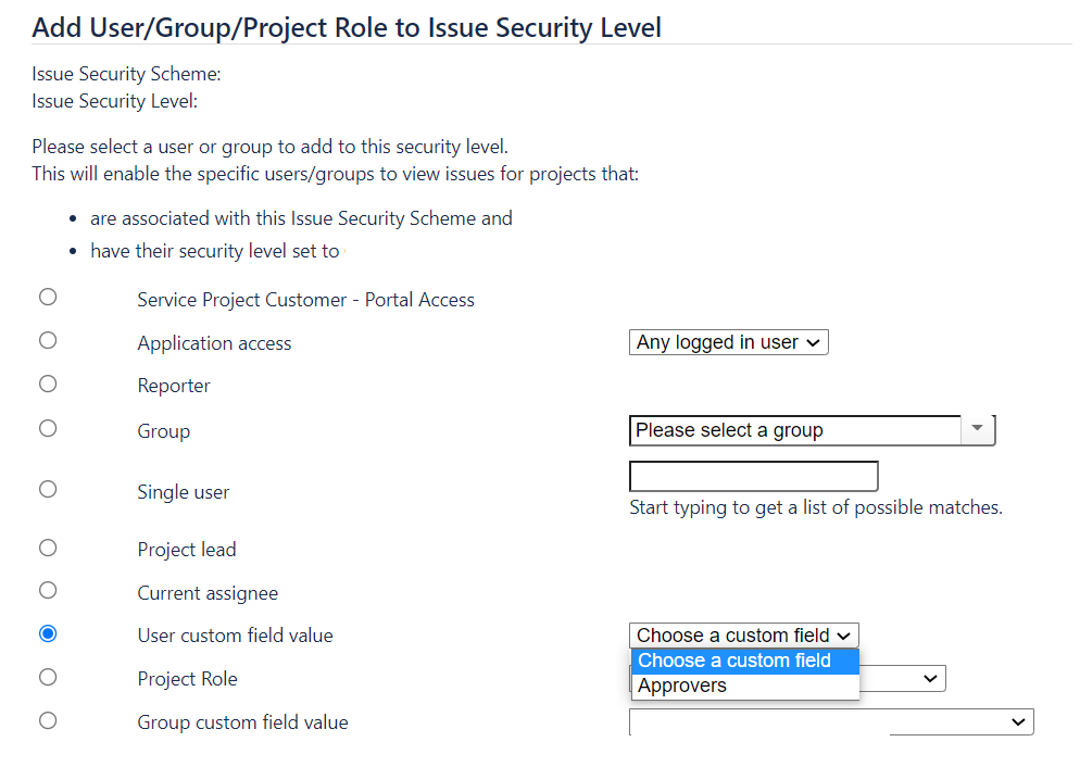

I have implemented an "Issue Security Level" to control who can and cannot view Issues. Accordingly, only the "Reporter", "Assignee" and "Administrator" can view the issue. This is working fine as configured.
However, with this Issue Security Level in place, the "Request participants" are not receiving any notifications. For e.g. the request participants do not get any updates about comments that the assignee writes under "Reply to customer" section.
Moreover, since the "Issue Security Level" does not have any option where I can Add "Request Participants" as one of the "allowed" personas to view the Issue. See the attached image...
Is there a way to maintain the Issue Security Level and also make is possible for the "Request participants" to receive updates / notifications?

You can try to create custom field (people picker - multiple users field type), then add in automation to populate the field with the values found in the Requested Participants field.  Afterward, you can add the custom field to the Issue Security by selecting it from the "User custom field value" dropdown list.

1. I created a CustomField, say "CF_Req_Participants"
2. Keep this CustomField "hidden" on Agent view / Customer view;
3. Configure an Automation rule that will populate OR repopulate this field at "Issue Updated". This means whenever there's any update on the Issue, this rule will copy the values of "Request participants" in "CF_Req_Participants"
4. Use this CustomField under Issue_Security_Level
Hope this helps...

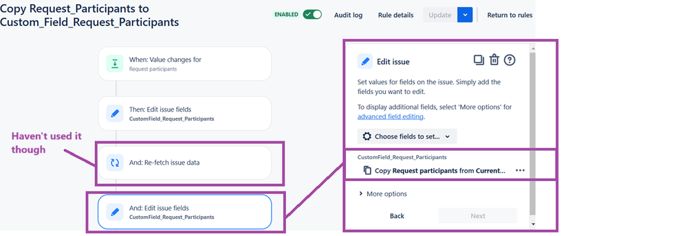

Hi @Ashraf B  I tried to configure as you mentioned here. I created a new field using multiple user type, so that the value of "Request participants" of the issue is copied to it when it is modified, but I can't get the information to be copied. In the automation log it shows a correct performance without errors, but the field is blank.
I could only get it to work using a single participant in the "Request participants" field, and defining a fixed value using smart values ​​in the automation, but if there are several users participating, which in our case it´s usual, it can be from 1 to n users, it doesn't work.
Could you tell me step by step how you have configured it, and if you use multiple participants?
Thanks!
Ashraf B February 7, 2025
Hi Noeli,
I have created Custom field "CustomField_Request_Participants" with "User picker (multiple users)" Type...
The automation triggers whenever there's any change (add / edit / delete) in "Request Participants" field and populates all the users in "Request Participants" field to "CustomField..."
Take a look at the attached image too...
Best regards,
