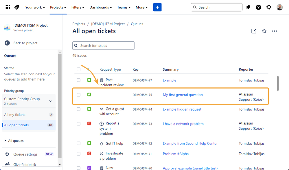

would be also yes. Although, when deleting req. type you're being asked/noted to (bulk) move all tickets assigned to that req. type to different one.
When talking about indexing/reports I don't see much of a choice than to leave all those issues 'active' in a way that you would move them to a new/different issue type and potentially add a label or some other mark just to know these are migrated. This way, you could still use them in reports. Or, if you could export those reports and 'timestamp' them, maybe an option for archiving would still be on the table? 👀
