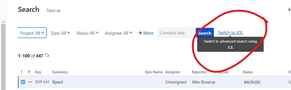

Hi @Tomasz Bis
Try the following to switch to advanced search using JQL

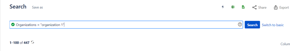

And then type something similar:
