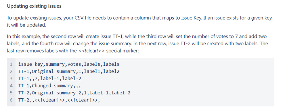

This is the information I'm going off: Import data from a CSV file | Atlassian Support

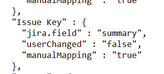

My config file I'm using to import:

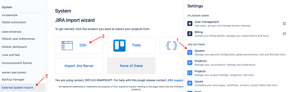

  1. Ensure you are using the CSV import option of the Jira administration page, and not the one in the issue navigator (... > Import issues from CSV), as this last option will not work to update issues.
    To use the correct CSV import of the administration page you should:
    1. Click on the cog icon at the top-right of Jira > System
    2. On the left menu, select "External System Import" > CSV:
