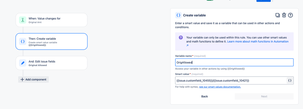

Objective: I would like to apply my automation that calculates decimal percentages to several fields. I currently have the same action being applied to 4 separate rules for the 4 fields. Here is just one:Screenshot 2024-07-13 at 10.47.12 AM.png

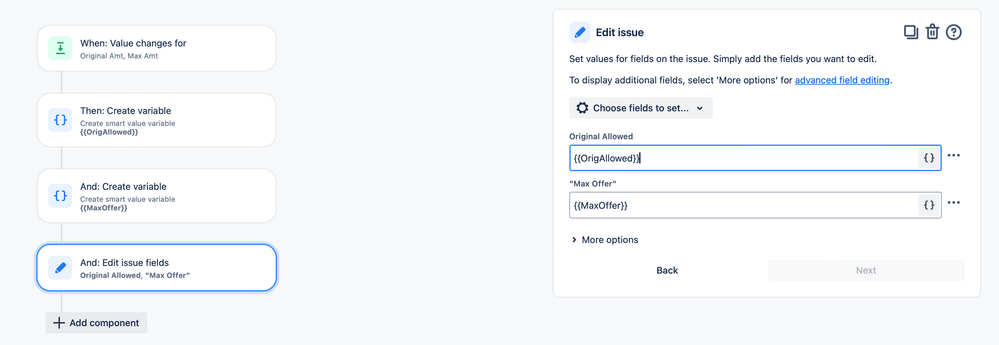

Attempted: I have attempted adding one other field to this and it did not work :(

Hello @Mireya Cintora
In what way exactly did the second rule not work?
Please share with us the information from the Audit Log for the rule's execution.
Please show us the details of the second Create Variable step.
What fields are being referenced in the Create Variable calculations? What are their values at the time the rule executes?
Have you looked at the Log Action? It is an excellent debugging tool. You can use it to write the values into the Audit Log. Use it to document the values of fields at any point in the rule, or to document the results of a calculation that you use to set another field.
Mireya Cintora
July 14, 2024
Thank you for the quick response. So I got this question answered here which then led me to troubleshoot this question! The issue was the my create variable which was not needed at the end.
