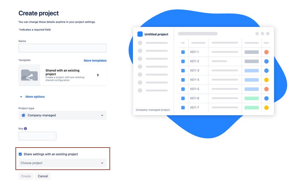

If it is, you can create additional Jira projects using the initial one as a template. At least, if you set it up as a company managed project. To do so, create a new project based on a Jira Work Management template. As long as it does have a company managed version, you should be fine. In this example, I chose Project Management. In the last step of the creation process - where you're asked to enter the project name and key - select the option to Share settings with an existing project. There, you'll be able to specify what your template project would be:
Screenshot 2023-01-01 at 16.45.41.pngHope this helps!
