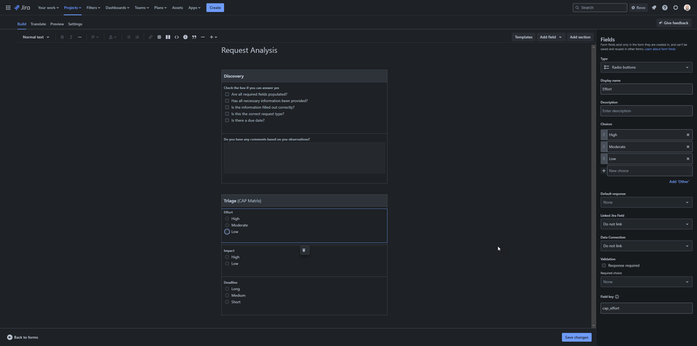

I want to use an internal Jira form to trigger certain actions using automation without adding a bunch of custom fields to the request type.
Current Scenario:
A request is submitted via the portal
A person reviews the ticket internally to prioritize and sets the priority field manually
When it comes to step 2 I want to use a Form to select radio buttons for Effort, Impact, and Deadline and based on the selected values automatically give the ticket a priority value from a drop-down list.
E.g. if Effort is High, Impact is High and Deadline is long set the CAP Matrix field to A2.
I know how I could do it if each Form field would be linked to a Jira field, but I don't want to add several Jira fields to each request type and was hoping to accomplish this using the selected values in the submitted form fields instead.
This example is for a quite short form but we want to use the same logic for forms that are longer.

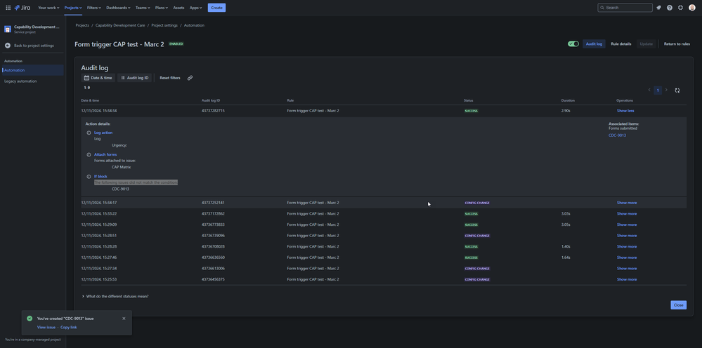

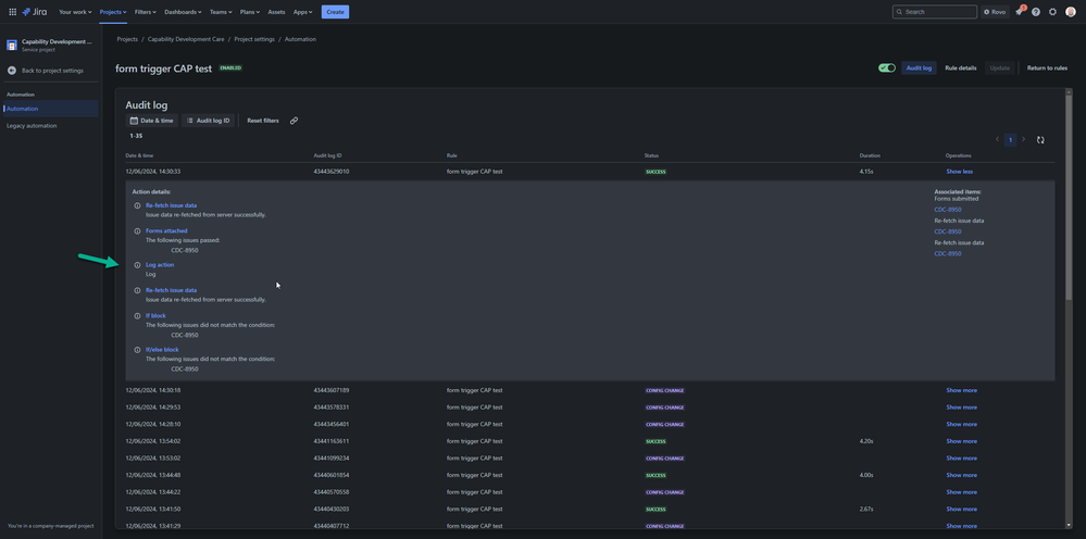

But the audit log says "The following issues did not match the condition:" for all of them.

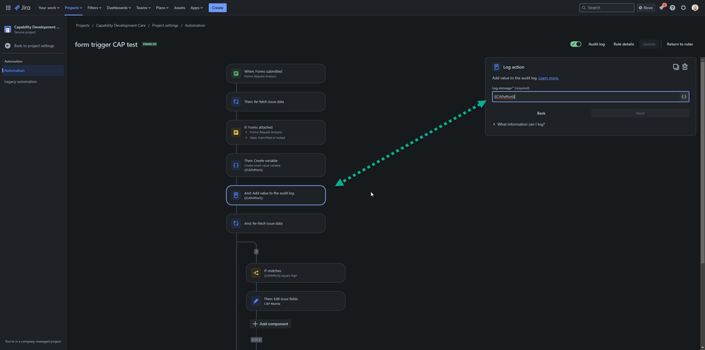

Add a log action after the creation of the variable and log the variable, what does the log action provide as result?
Yes and there is no result in the variable.
So looking back on your form, your radio button option is called Effort, so the smart clause used when creating the variable should be:
{{forms.last.Effort.label}}
Do you get result at the log action?
No sorry no Log for that either.
Since I put in a "Field key" in the form I was under the impression that I should use that.
But I tried both {{forms.last.Effort.label}} and {{forms.last.cap_effort.label}} before and after removing the "Field key" and saving the form.
I also tried a different "Field key" capeffort without the under score (_) but that did not help.

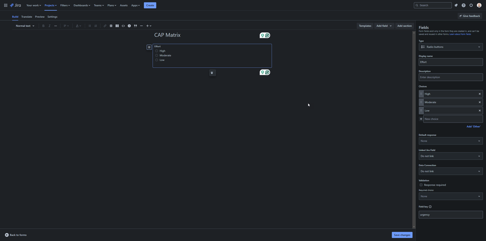

In the rule the action Attach Form is required and you indeed need to set Field key, to retrieve the set information. (Field key is capital sensitive)
See my simple example:
I made a form with the field "Urgency" and Field key "urgency".

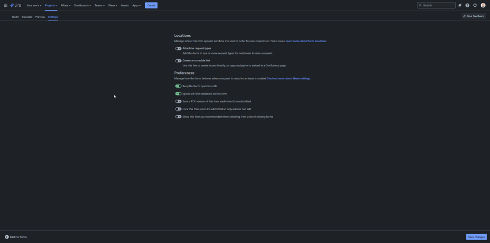

On the form config I see you didn't add the from to a request type, this is required otherwise the form is not used on a request type.
Steps are simple
Yes, that is correct I don't add it to the Request Type, because if I do the form is shown to the portal and we don't want our Reporters to see or fill out this form, it's for internal use only.

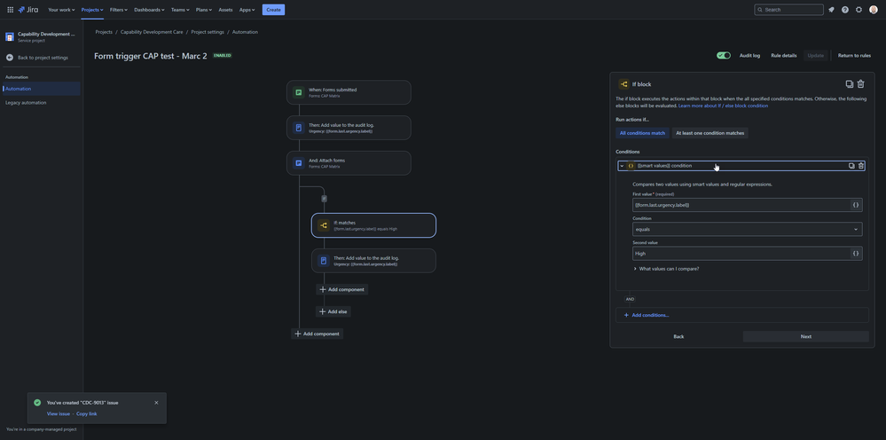

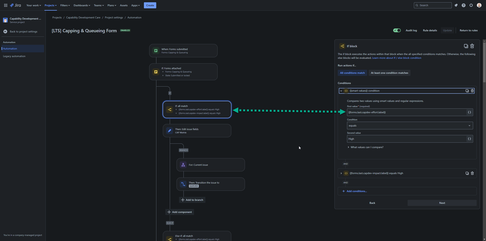

I tried this (see image) as this is how I understood your message above and the log says "The following issues did not match the condition:" for both blocks.
So somehow it doesn't recognize the values that I select in the form.
And this is the whole rule.
I also tried the smart value {{form.last.Effort.label}}, both with the "Field key" field in the form set to blank or Effort and the log still says "The following issues did not match the condition:" for both blocks.

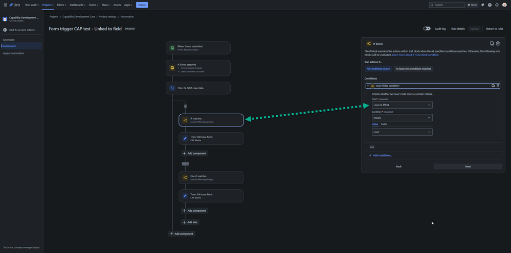

A possible workaround that works:
I tried linking the Effort form field to a (similar) Jira field called "Level of effort" (that I don't have on the issue screen or in the request type).
This way I could accomplish what I wanted with the form without adding any custom Jira fields to the issue screen/request type, the values are logged in the background.
But it does require 1 custom Jira field per Form field, which I'm trying to avoid.
