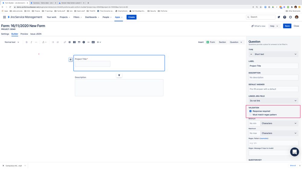

Hi Henry
Yes, configuring within Jira is an option.  You can also use compulsory fields using a free app called ProForma Lite.  It allows you to configure compulsory fields without too much effort.
Essentially you tick the compulsory field and that activates the required field feature.
