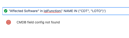

Here's what I'm getting.. (I can confirm the attribute is NAME and the object names are correct)

I think your original query was actually correct with the single ticks. However, IQL may be case sensitive. Try using Name instead of NAME
Wow. Surprisingly it just didn't like the capital "s" in Software. Apparently that part is case sensitive, not the "NAME" part. Thanks so much for you help with this.
Yes attribute names are always case sensitive in IQL queries. Values are normally not case sensitive if you use common equal sign (=). Using double equal signs makes values also evaluate as case sensitive.
