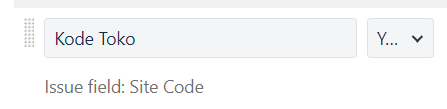

Saries Ardiantoro
February 4, 2022
Hello @Simon Herd
I've already linked a field in the form to a jira field
but it's not populated
so I failed to create the issue because this field is required
what to do?
