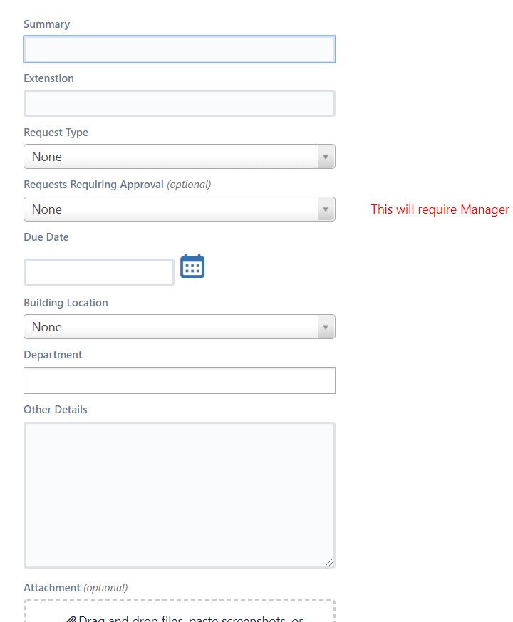

I have this Service Desk request Type with these fields:

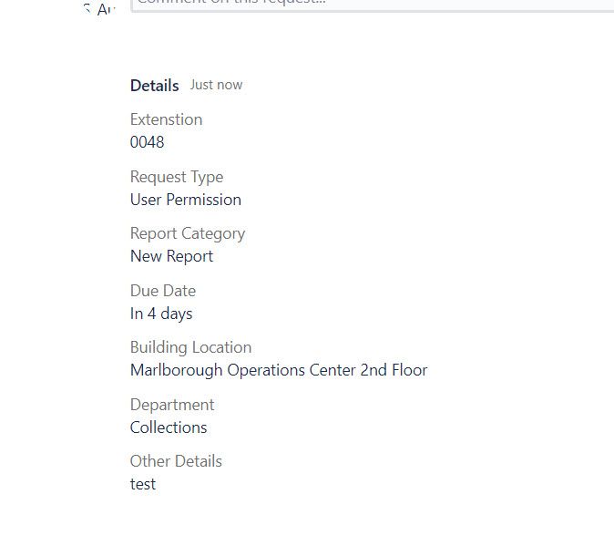

When I create the ticket, on the SD side and Agent side, I have the report category appear with an option selected:
I need this field on the screen scheme as it used when the Report Request Type is selected so perhaps the contexts is what I'll need to work with but why does it display with "New" selected when the field options are None, New and Existing?

Hello @Sarah Aubuchon
It display with the "New" value because it may be set as default value. You can look at the cutomfield if there is no default value or context field

@Mohamed Benziane , thank you very much! This resolved the issue. When I remove "new" as the default value, the field no longer displays on unwanted tickets.
