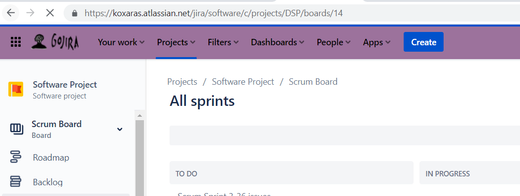

First of all you have to acquire the id of your sprint "Claims detects for cosiderati". To do that you have first to get the id of your board. This is located on the address bar of your browser:
In the above example the sprint board id is 14.

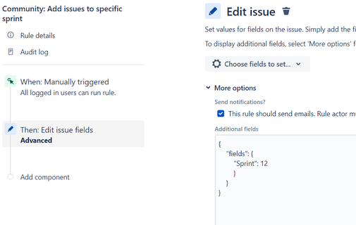

Finally, go to your rule and when you will try to edit your issue, do not use the predefined fields to edit the sprint. Instead go to the "More Option" and enter the JSON text as you see it below. Replace of course the number 12 with the id you found from your rest api call.

I was able to get the id and automation is working!
Thank you!
