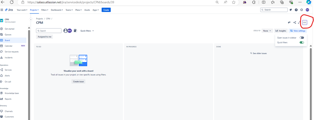

I added a IT service desk general type project, I have a custom workflow that is added, but I cannot change the name of the status to match my workflow on Boards. Nothing comes up when I click three dots . Any help is appreciated. The goal is the change to column names to match our custom workflow.
It appears that there may be a bug, as I am experiencing the same issue.

I cannot as nothing happens or no options are visible when three dots is clicked.

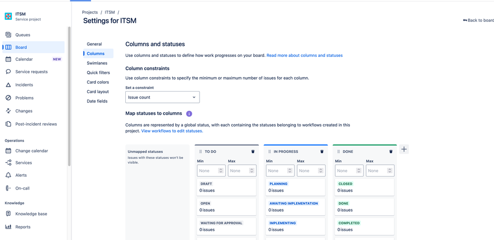

I have created a test service management project, and the option to configure the boards is available:
@Nikola Perisic could you suggest what template have you used, is this permission issue that i am unable to click the dots? I need this please , thank you
@Revathi Nukala I have used the General service management for IT teams. But this isn't the case on why this is not working for you. Like I've mentioned within my answer, try different browser, try incognito, clear cache. Another thing, open your browser developer console, try to click on the three dots again and see if there are any errors.
More tools > Dev tools - this is for the Chrome browser
@Nikola Perisic no console error when I am checking dev tools. Did not work in incognito mode or different browser
Hello @Revathi Nukala
Are you the board admin for this project? If yes, try different browser, start in incognito and clear your cache and try again.
@Revathi Nukala Have you tried using different browser, incognito mode, cache clearing? If none of the options is not working, this is something that needs to be addressed to Atlassian Support: https://support.atlassian.com/
@Nikola Perisic yes bing did not work, chrome did not work. I have another project of type Software project the board configuration and click on three dots work just fine in that. But it is this service desk project no luck
