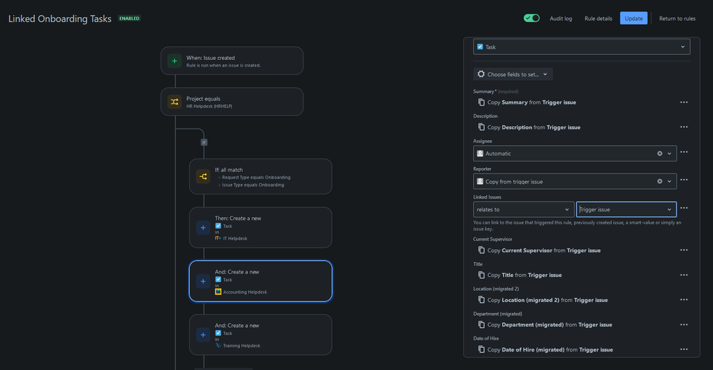

I built an automation that creates child tickets for onboarding and the tasks show up as expected. But they don't carry over the fields that I've set for it to copy from the trigger issue. I've attached a screenshot to illustrate.
Also, when the tasks are created, they don't change to the request type they need to be. The field shows up blank and I have to select it from the dropdown. I've tried to automate it but it doesn't seem to stick.
Is there anything else I can do to make it a seamless transfer of information from the trigger issue to the tasks?

Can you try adding a "Re-fetch issue data" Action jist before the Issue creation action? At times the automation needs to get the data prior to passing it down to the next step.
Would also suggest adding a Log Action which will print the trigger issue so that you can verify if the execution is correct.

Can you share a screenshot with the "Re-fetch issue data" action used?
I don't see this in your previous image.
