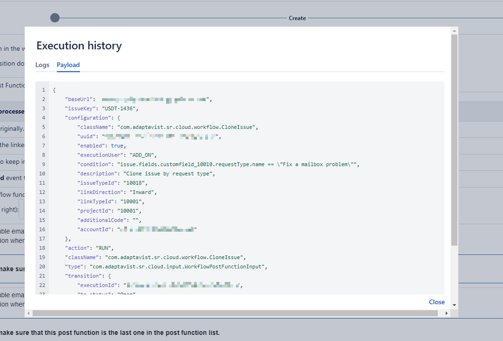

My team and I are using a post function scriptrunner for jira cloud to clone items for other projects.
We are faced with a scenario in which cloning of items should only be done if the type of request (customfield_10010) is the same or different from that informed.
I've already tested both ways within the post function as shown in the image below, but without success.
This happens even when opening tickets corresponding to the type of request informed in the ID.
Has anyone seen anything like this? Can you help me?
Thanks!

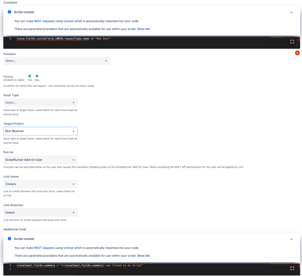

Did a check with my Jira Cloud instance to test the Built-in Clone Issue again. Try using this:
issue.fields.customfield_10010.requestType.name == "New user"
I set mine up as a Post Function when I transition to "Done". It successfully cloned general details within the same project, and then tried it to another JSM project - both works. I would assume that it should work with any other project as well to clone the general default field details. If you need to fill up fields and/or other specific details, you can add the code at the bottom console for "Additional Code".
Here is the workflow set up:
And this is the ticket which was cloned/created in the other project and linked back to original ticket:image.png

October 20, 2024
hey @Laura Jimenez Valencia ,
I just did another test, incase there was any changes, and it looks like it still works, when I set the condition with:
issue.fields.customfield_10010.requestType.name == "For Demo General"
I don't think it is a case-sensitive issue, but you could try something like:
issue.fields.customfield_10010.requestType.name.equalsIgnoreCase("for demo general")
Anyway, I created the ticket directly from portal and had the post-function run:
My views:
Eg1: ScriptRunner for Jira Cloud's workflow page:
Eg2: Workflow (edit) page, I believe you are trying to do a post-function at portal ticket creation/submit:
If you've tried it all, well, the only other recommendation I have left would be to create a Support Ticket with us and let our support engineers give it a shot.
Laura Jimenez Valencia October 15, 2024
Hi @Sean Chua _Adaptavist_ ,
I have the same problem, and I test your solution and doesn't work. I don't know why. I add screenshots of my test. Can you help me?
Snipaste_2024-10-15_10-40-25.pngSnipaste_2024-10-15_10-41-16.pngSnipaste_2024-10-15_10-41-48.pngSnipaste_2024-10-15_10-43-20.png
Thanks!
