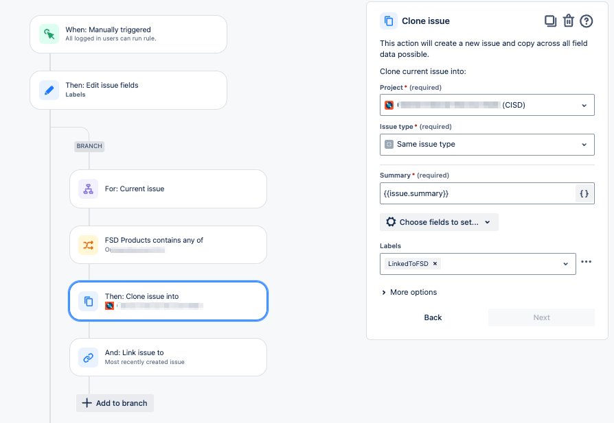

I've set up a manual trigger automation rule to clone a ticket from one project to another.
However, when the rule is triggered, the cloned ticket isn't assigned a request type:

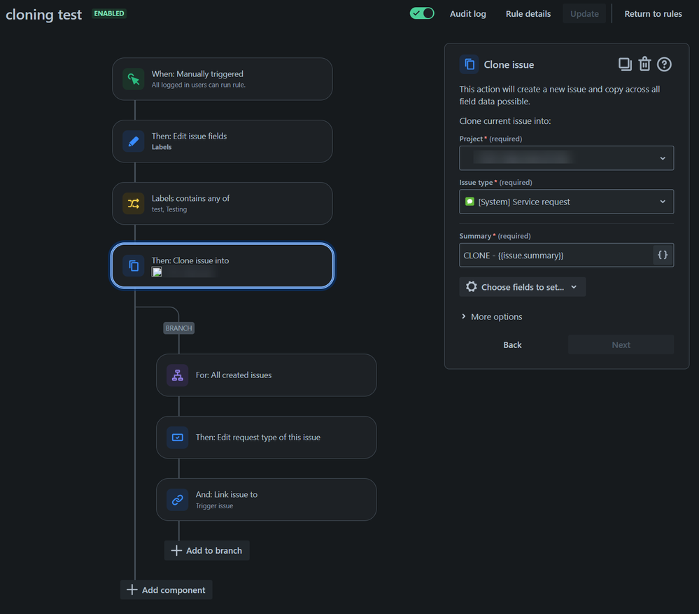

Editing the request type is a little tricky when creating/cloning issues. Also, the branching gets kind of funky as well. I've recreated your automation and tested it. You might want something more like the screenshot below. Pulling out the IF condition into the main branch is totally okay and then the branch on created issues from the automation is really the key. Make sure to set the project and issue type explicitly in the clone step.
Also a suggestion from our past experience - you may want to add an IF statement early on that checks if an issue is linked already with a certain criteria. This helped us when people clicked the button multiple times accidentally or because the automation didn't run in 0.05 seconds :-)

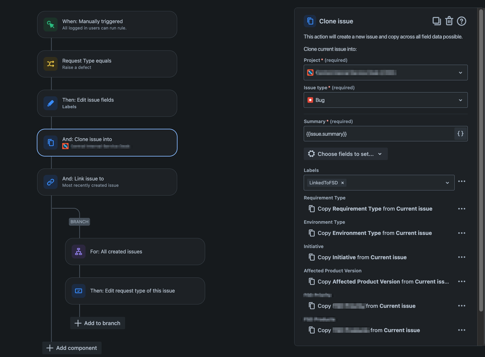

There is more than one issue type in the original project so I included an IF condition at the start of the main branch and then I followed your screenshot with the branch condition. I also moved the "Link issue to" condition to the main branch as the linking wasn't happening when placed in the branch. However, I'm still having the same problem.

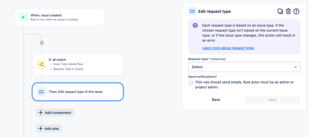

Weirdly, I created an automation rule in the target project to set the request type where a created ticket has an issue type but request type is empty (below).

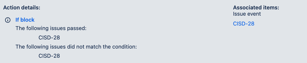

But when I run the rule in the original project and a ticket is cloned to the target project, the cloned ticket still doesn't have a request type. The audit log shows:

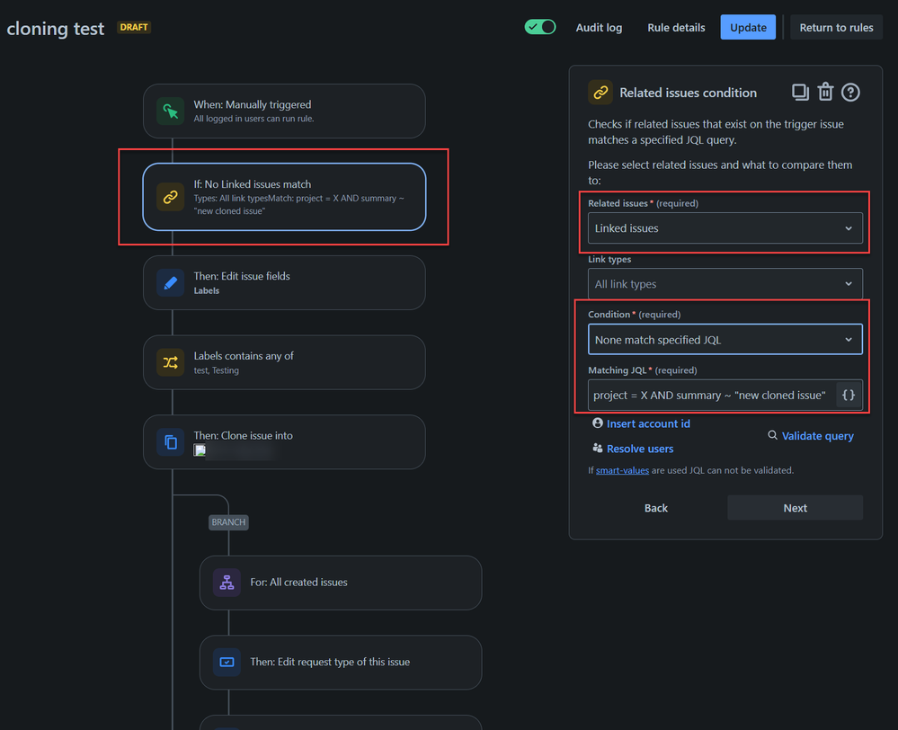

Also, to answer your piece about checking if the automation ran already, so as not to create duplicates, I would do it like the following:
  • Add an IF statement for related issues condition
    • Set the related issues to linked issues
    • Specify a link type (optional)
    • Set the condition to None match specified JQL and enter a JQL below, probably with summary or other things you set already with the automation the first time through.
This should make it so if one exists, it won't continue down the path in the automation again!
