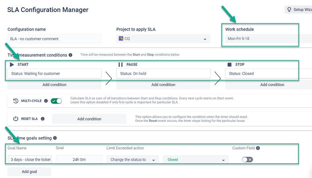

Hi, @Ste404
I would recommend you to try an SLA plugin which will make this action fast and easy. For example, in SLA Time and Report for Jira add-on you can set up this process via SLA Manager by just creating a new SLA Configuration, where you need to:
That's it! If you follow the steps from above, you'll achieve your goal and your ticket will be closed after 3 'Business Days' with no customer comment.

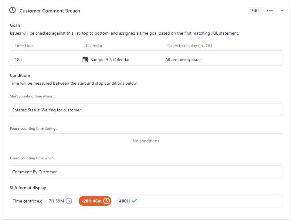

Hi @Ste404
SLA will definitely solve your issue.
This is the way to go, there is no need for additional plugins
Thanks for the input, I think I am on the right track here - how does this look?
(18h was just my testing)
That's fine. It seems you give 2 working days as a target (2x9).
Now you can configure similar automation:
