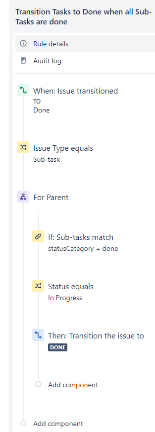

If I recall correctly, there is a similar automation in the library to do this with sub tasks. If the main task is complete, close the sub tasks, and if all the subtasks are closed, close the main task. you might be able to use those delivered automations as templates.

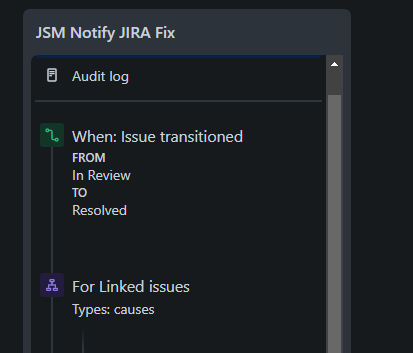

That would still work, you can look up the linked issue type. I'm doing something similar:
