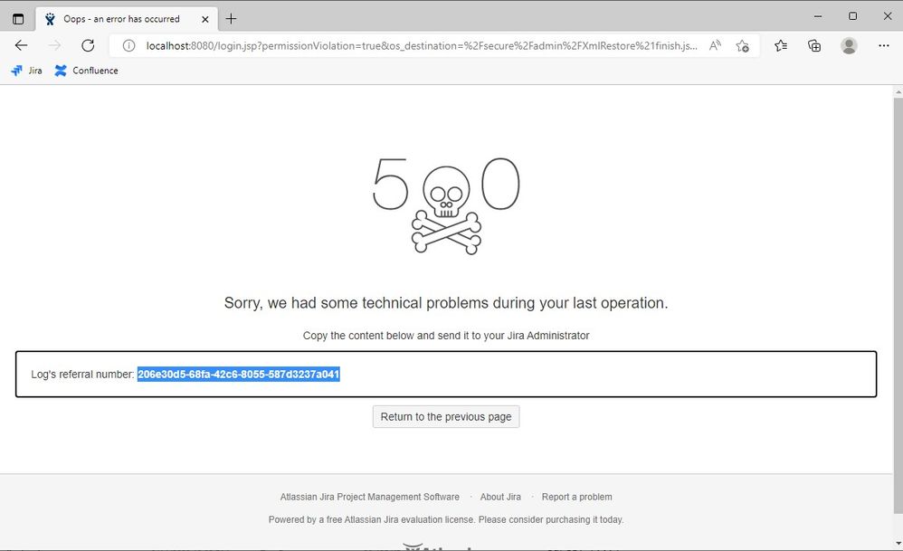

I created a VM on which I've installed Jira & Confluence Data Center instances. I then took backups of the source Jira & Confluence cloud instances. I then attempted to restore the Jira backup with the Jira DC instance. This is where I am now stuck. The restore gets to 90% and then I get a 500 error indicating a log referral number of: 206e30d5-68fa-42c6-8055-587d3237a041.

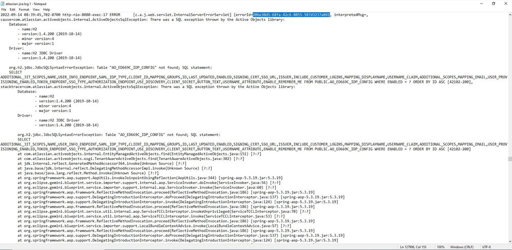

The log indicates that a database table was not found.
I've been following the steps found within this article (currently at step #4): https://confluence.atlassian.com/adminjiraserver/migrating-from-jira-cloud-to-server-applications-938846963.html

For your Jira issue, I see that you are using the H2 database that is really meant for evaluations.  For something like this, you really need an enterprise-class database (PostgreSQL, MySQL, Oracle, MS SQL Server).
