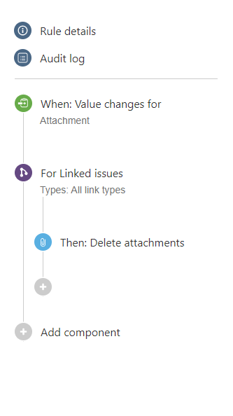

This is the automation that delete the attachments:

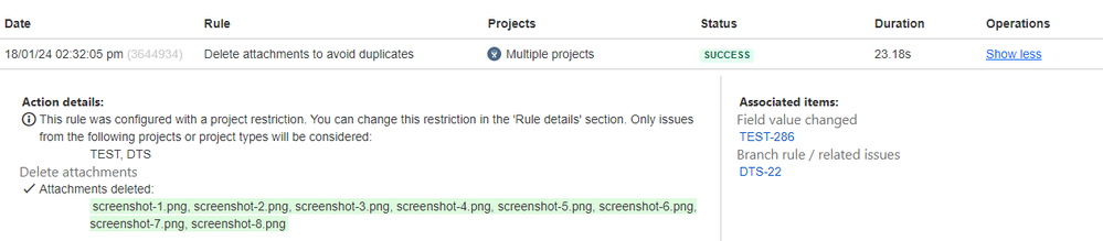

This is the audit log:

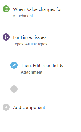

This is the automation that copy the attachments:

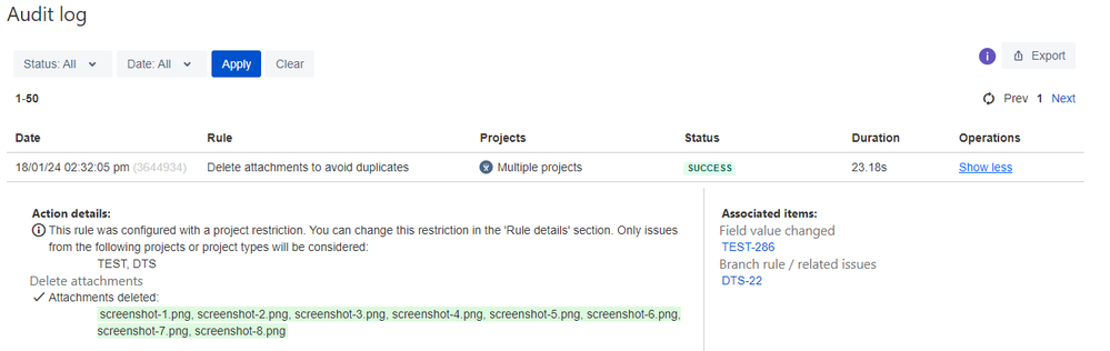

Audit log:
I just realized that the attachments are indeed being sent correctly, but then they get deleted. In other words, they are copied successfully to the parent ticket and then removed. I would need to reverse this process, deleting them first from the parent and then sending them from the child.

Your second Audit Log image is the same as your first, for the Delete Attachments rule.

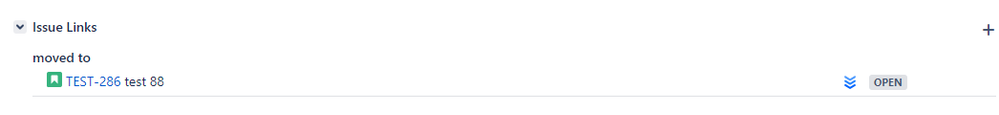

#2: In the images not, but I tried specifing the link types and the result is the same, the link types of my issues are these, moved to, and cloned to:
In this case: DTS-22 Is the parent, and TEST-286 is the child

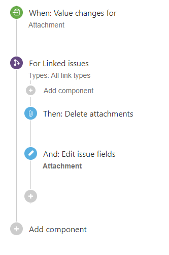

I tried with just one automation too, but again, it didnt work out...

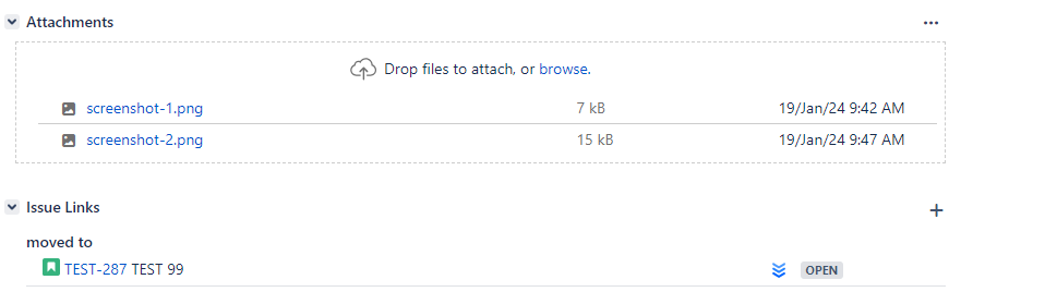

This is the automation that I tried:

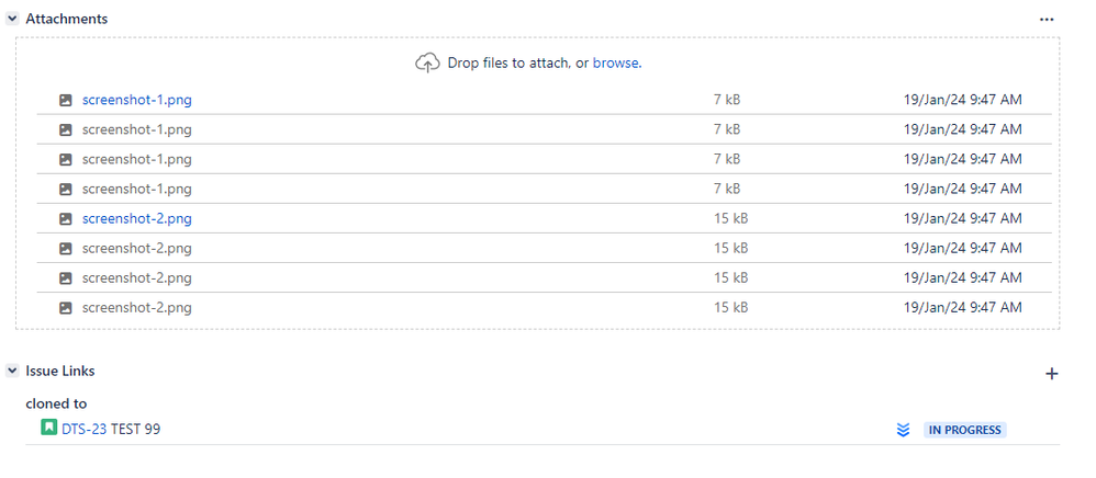

This is what happens if i run that automation:

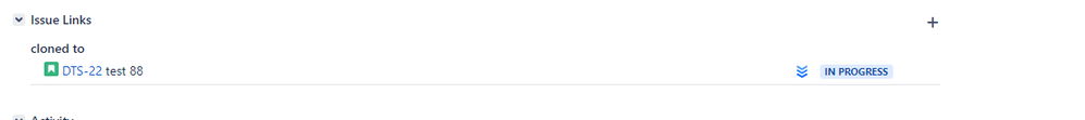

This is the parent ticket, I just placed the "screenshot=2.png"
And this is the result in the child ticket:

So, one thing you need to do if you are using a single rule to both delete the attachments and then add them is add a Re-fetch Issue action in between the actions that delete and add the attachments.
