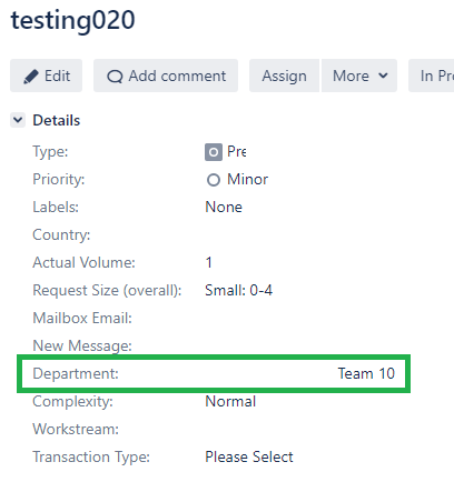

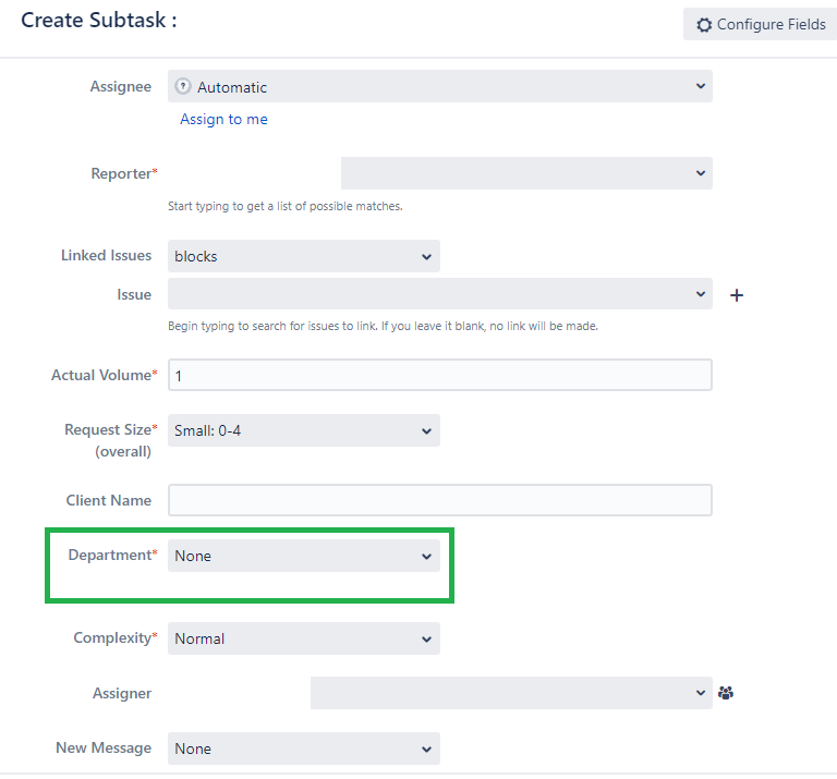

May I know it's possible that copy field value from issue to create sub-task automatically?
As example on below screenshots: Department in issue is Team 10, and I wish Team 10 can copy to Create Sub-Task screen.
Ken

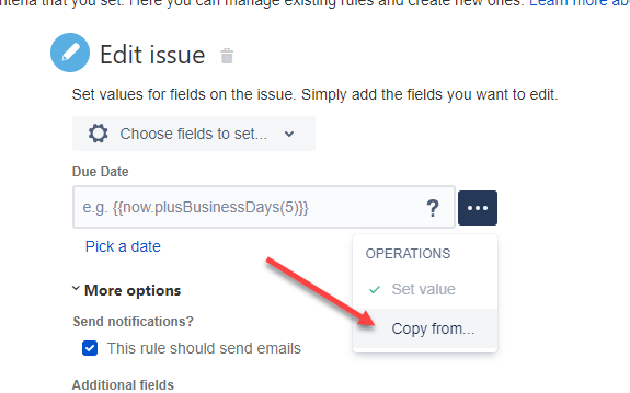

In the automation rule, you will need to update the Edit Issue action as follow -
1) Click on the "..." icon and select Copy from option.

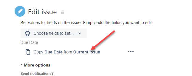

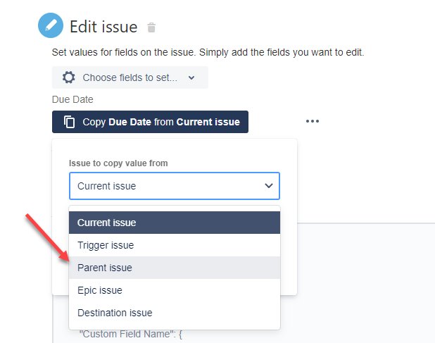

2) Once it is done, click in the "Copy xxx from Current issue" box and change the Current issue to Parent issue.-
Afterward, save the automation rule and publish it.  You are all set.  Please note that in my example, I was copying the Due Date field from Parent to the Subtask.  In addition, you want to make sure the your Department field custom dropdown option context is also applicable for the Subtask issue type in your project.

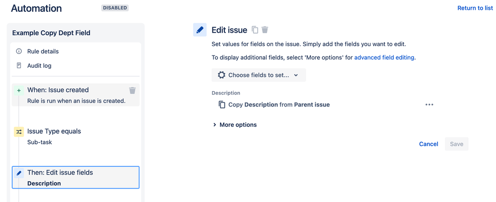

The triggering event is not correct, you should use issue created event and add the condition to see if the issue type is a subtask or not.  If so, then update the subtask's department field by copying it from the parent issue.

Thank you Joseph. Is there a way to copy field value during the sub task creation, not after created? Because currently the field is required, we need to select the value before create it. And we would like to copy it automatically, no need to select it manually.
Ken

However, you can update the Department field after the sub-task is created with the value from the Parent ticket using an automation rule that looks similar to below:
For the Action, select "Edit Issue" instead of "Create Sub-Task." In the Edit Issue, select your Department field. Then click the triple dots on the right side and select "Copy" and then select "Parent Issue".
