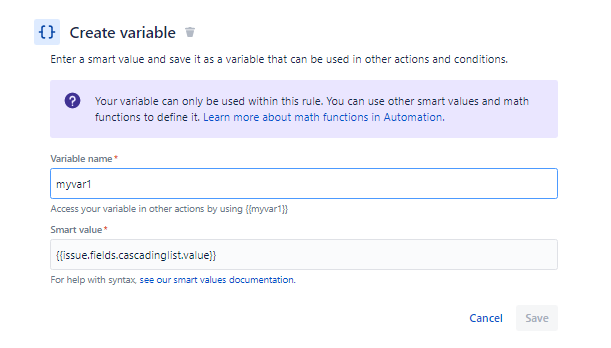

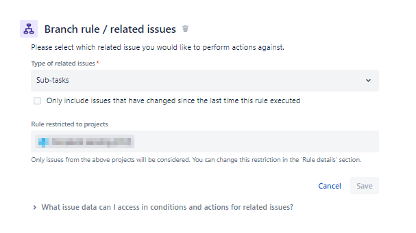

I tried to get the value by using the Branch "For sub-tasks", then create three variable :
for example :

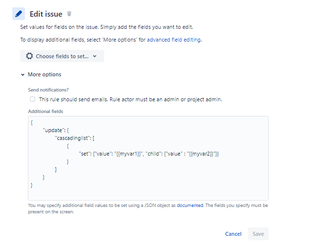

Then i tried with additional field in json such as :
"update": {
"NAME OF MY CASCADING LIST": [
"set": {"value": "{{myvar1}}", "child": {"value" : "{{myvar2}}"}}
But nothing seems to work,

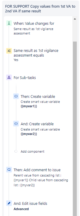

Hello, thank you for your anwser, please find some screenshots
Hello @Térence LECROIX
Thank you for those images. That is very helpful.
In order to use the variables outside of the branch you will need to create a variable outside of the branch before it executes.
Refer to the workaround shown in https://jira.atlassian.com/browse/JSWCLOUD-22527
