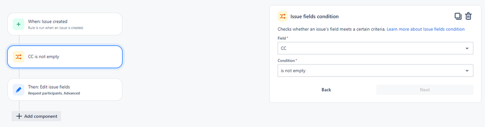

Touqeer Anjum
December 20, 2023
Thanks..
In the image CC is the customfield.

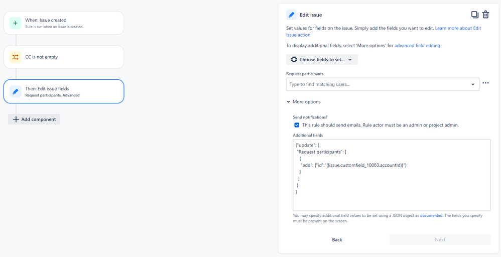

Touqeer Anjum
December 20, 2023
I changed the code (as in image 3) to test it differently, still the same error..
Jack Brickey
December 20, 2023
Can you uncheck Request Participants in your Edit issue component and simply use the JSON.
Touqeer Anjum
December 20, 2023
Unchecked and now the error is
Error while parsing additional fields. Not valid JSON.
