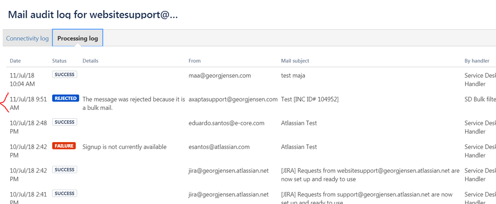

We just tried sending the email from our Dynamics AX support system, and the email what not received. According to the log,it was rejected - how can we get this to work?support.PNG

Something from that email is causing Service Desk to flag as junk mail.
Can you confirm this email address isn't a forwarder? Do you happen to have another (external) email address you could set up to collect issues rather than the internal one? This way we could check the headers and see why Service Desk is flagging it as bulk.

Just to review, the primary issue here is that Jira doesn't like emails coming from the axaptasupport@ email address. It sees them at bulk, most likely that email address is either a forwarder or group rather than a single email account on your server.
My proposal was to change from the internal account to an external account which will collect the email addresses. Once you change this, you can then go look at the email itself that was rejected, and review the full headers. It will give us more clues to see why they're being rejected.
