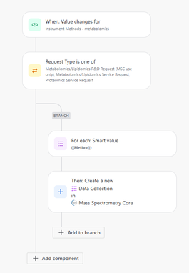

I have two multiple select list fields that I would like to create sub tasks for each option select.
For example what I need:
custom field 1 has the options: a, b, c, d, e
custom field 2 has the options: 1, 2, 3, 4, 5
If "a, c, e" are selected and "1, 4" are selected I'd need the following subtasks:
a, c, e, and, a-1, a-4, c-1, c-4, e-1, e-4.
What I have: 2 different automations (showing 1 below, set up identically but with different smart values) but I'm still left having to manually create some sub tasks and wonder if there is a way to automate it.
With the 2 rules I have now I would get the following subtasks:
a, c, e, 1, 4
 Is there a way to iterate the sub task creation over multiple smart values?
