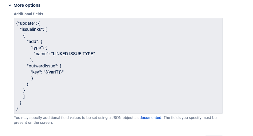

Hi @Aaron Geister _Trundl_ - I think you need a couple things here:
{"update": {
"issuelinks": [
"add": {
"type": {
"name": "LINKED ISSUE TYPE"
"outwardIssue": {
"key": "{{varIT}}"
Yes, but you need to set the link type that you want (e.g. "Relates To", "Blocks", etc.)
Where do I put that at? In the Json?
Yes - Just replace LINKED ISSUE TYPE in my JSON
Thank you so much been chasing this all day and it was much simpler than I thought. I started by trying to query a global query to do this and link issues after the fact.
You have saved me many hours!
I appreciate you!

Yes you can definitely add the clone link to the trigger issue. You should be able to perform it in the same update action. Try this:

Thank you. This is all json correct. I am wanting to learn the format so I can do this daily. I need to look up more how to formulate these. Do you have any suggestions? Good sources.
I haven't found a single reference for this stuff. I've found most of my answers searching here in the community. However, ideally you want the "More Options" section to be more the exception than the rule. Technically, you could have branched into one of the new tickets and used the add link action for this scenario. I just proposed this approach to reduce the overhead on the rule.
