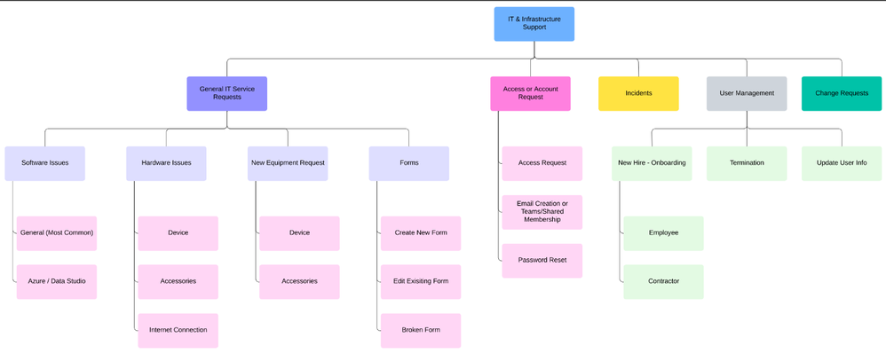

Chad Fedie October 8, 2024
@Kai Becker
Are you able to elaborate further on the first option where you can utilize single select fields? I'm using an IT Service Project and would like to follow an outline show in this screenshot. JIRA Outline.pngThanks!
