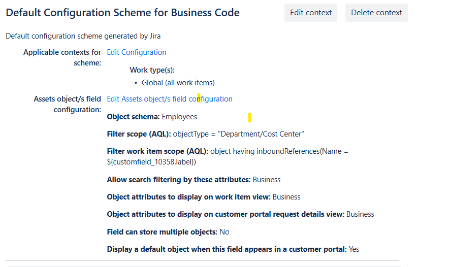

In the configuration I have put
Allow search filtering by these attributes: "Business"
Object Attributes to display on work items view: "Business"
Display a default object when this field appears in a customer portal: Yes
It will only display Name (Identifier).  How do I change it to display Business and not Name?

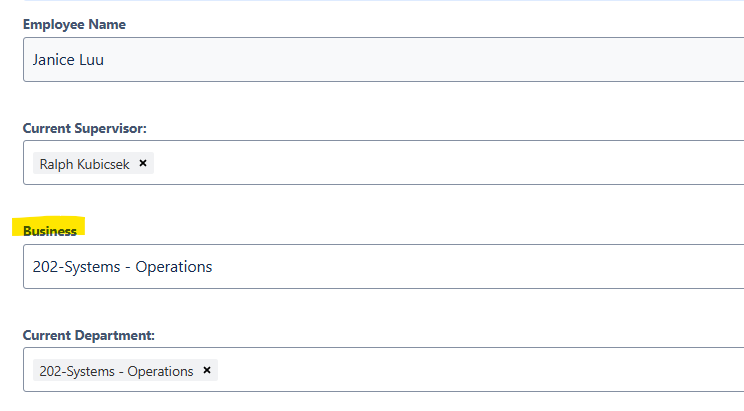

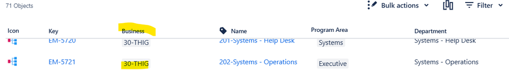

Janice Luu July 6, 2025

Hi @Janice Luu , from your description it looks like you are on the right track. Is it possible to make a screenshot of what your field configuration looks like and how you see it on the portal?
Oleksii Melnyk
July 4, 2025
If you want to see it on the portal you need to add Bussines to Display these attributes in the portal request details view
I have attached the screenshot, I believe display on customer portal = business is what I want, but as you can see it still display the name field
